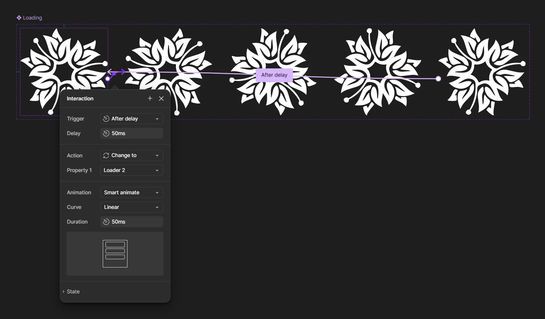

My loader isn't working
I’m not sure what I am doing wrong.
I created the shapes, and made 5 copies and rotated accordingly, then I made a component set and put in some protype settings according to a loader I saw that worked and mine doesn’t.
Any help would be wonderful.

Probably you were rotating the variants instead of a vector shape inside them. This is the most common reason why this kind of animation doesn’t work.
