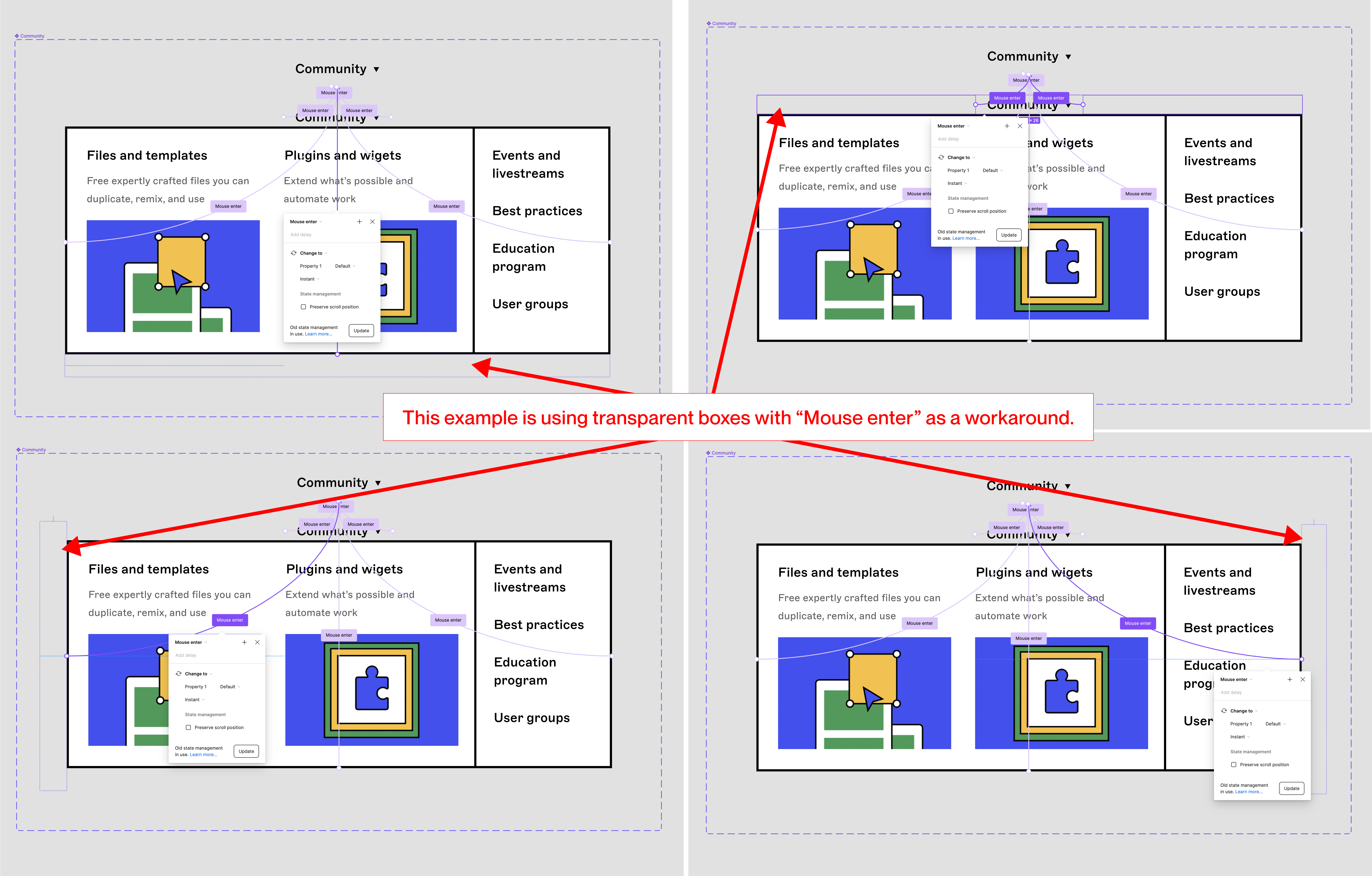

Here is the staff answer
Hi there,
I checked your overlay. “Mouse Leave” triggers whenever the mouse is outside a section, ‌not if the mouse enters and then leaves an area. Therefore, your overlay is both closing and opening at the same time, this is what is causing the flickering. To make this work properly, I would recommend using interactive components instead of the Overlay feature. An example of what I’m talking about is in the community file below.
https://www.figma.com/community/file/1101844796311678876
Still not sure why I should use interactive components instead of using mouse enter/mouse leave but well… I’ll try to figure out one of those days
Van_Wang
  • June 28, 2023
This explanation is misleading. There seems to be a bug associated with the “Mouse leave” functionality. Even in the example they provided, the solution involves a workaround utilizing “Mouse enter” alongside transparent boxes surrounding the dropdown menu to accomplish the intended purpose of “Mouse leave.”
In the example above, they give themselves away. Instead of using JUST ONE “mouse leave” behaviour (whish is obviously bugged) they have to wrap the whole menu to empty boxes with “mouse enter” condition. This kinda solves the problem in some ugly way but at the same time clearly DEMONSTRATES that the problem is still there.

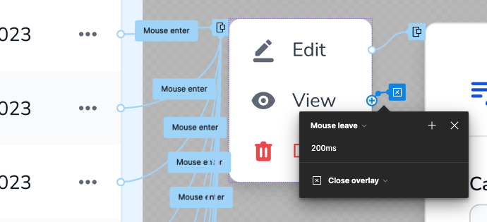

McKinley
  • August 31, 2023
I think I figured out a workaround. The overlay flickers because of the mouse leave interaction is set to the overlay itself, not the triggering frame. So the triggering frame keeps opening the overlay and the overlay keeps closing it if your mouse is not on top of the overlay.
In order to eliminate the flickering I set a 200ms delay to the mouse leave interaction on my overlay. So now I have enough time to move my mouse cursor over to the overlay and it doesn’t trigger the overlay to instantly close again.
Screenshot 2023-08-31 at 3.16.30 PM
Hope that helps!
