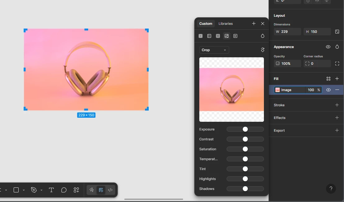

Screenshot attached for reference.

    Are you still having issues with cropping the image? I just tested this in the desktop app and in browser and it’s still working as expected on my end, and your screenshot looks correct as well.
    To crop an image:
    1. Select a layer with an image fill.
    2. Choose one of the following:
      • Click  in the properties panel.
      • From the Fill section of the right sidebar, click the image thumbnail. Then, open the image mode dropdown and select Crop.
    3. Click and drag one of the 8 blue handles around the image to crop it. You can also:
      • Reposition the image: Click and drag.
      • Resize the image: Click and drag the edges of the image.
      • Rotate the image or crop section: Hover on the outside of a corner until the  rotate cursor appears. Then click and drag.
      • Keep the current aspect ratio of the image or crop section: Hold ⌘ Command for Mac or Control for Windows while cropping or resizing.
      • Crop or resize opposite sides of the image or crop section: Hold Option for Mac or Alt for Windows while dragging.
    4. Click anywhere on the canvas to apply the crop. You can also press Esc or Return.
    To quickly crop an image, you can also hold Cmd for Mac or Ctrl for Windows while clicking and dragging the corners of the image.
    More information and details are available in our Help Center article: https://help.figma.com/hc/en-us/articles/360040675194-Crop-an-image

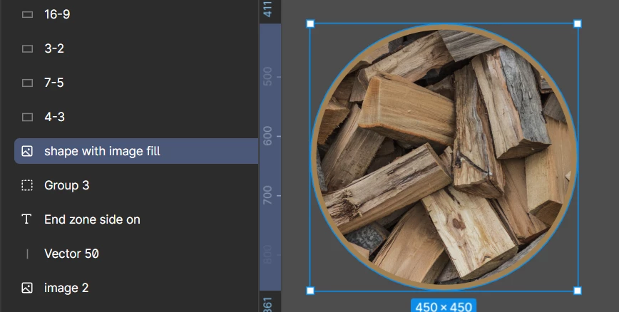

    The workaround from @Wirkkarl does not exactly work because when you apply an image fill to a shape there is not a separate image layer to select (see image below). However, I discovered that you can enter crop mode by pressing Alt + double clicking the image.
    Shape with image fill has no separate image layer
    As you suggested, the main issue I face is the lack of visible handles on the image when you are in crop mode, to indicate that you can manipulate the image. I can understand that seeing two sets of handles is not the neatest solution, but hiding the image scale functionality until you hover over it is not obvious. Not sure if this behaviour has changed over time, but on several occasions I've had to resort to a google search just to remind me how to complete this common task.
