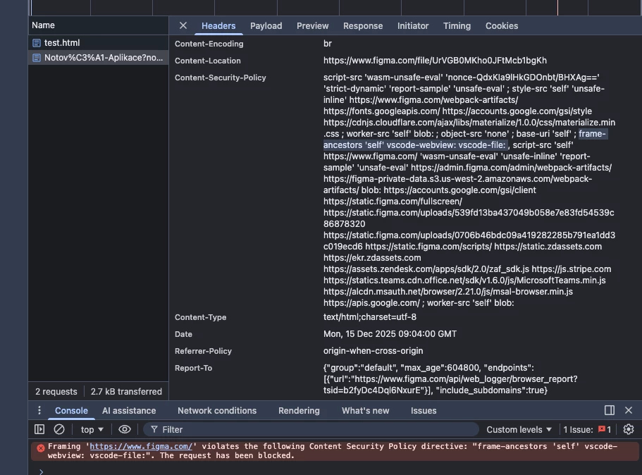

It looks that Figma make it not possible to embed make-figma into iframe. Figma explicitly forbids to include self into iframe. Here is Content Security Policy (CSP) header of make-figma.
Thats why:
`frame-ancestors 'self' vscode-webview: vscode-file: `
Unfortunatelyl, you are right.

I also tried embedding a Figma Make file using similar embed URLs, but in my tests this consistently resulted in a CSP error such as:
“Framing 'https://www.figma.com/' violates the following Content Security Policy directive: frame-ancestors 'self'”
From the response headers, it looks like Make content is redirected to `www.figma.com` and explicitly disallows iframe embedding.

NMSSolution
Dec 15, 2025 9:11 AM UTC
Thats why:

Thanks for the detailed investigation and the minimal repro example — that’s very helpful.
Yes, I agree with your conclusion. Because the frame-ancestors 'self' directive is explicitly set in the CSP for Figma Make, embedding Make apps in an iframe is currently not possible, and disabling web security only works locally for development, not for real users. The redirect from the old URL format also confirms that there’s no supported workaround at the moment.
Given this limitation, sharing the Make app via a direct link seems to be the only viable option for now. We may also consider reaching out to the Figma dev team or submitting a feature request, as iframe embedding could potentially be supported in a future Embed API.
