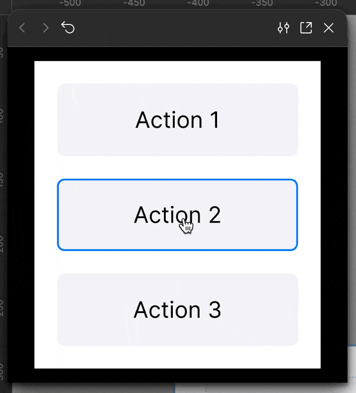

Tamara_Did_Design
I made a quick prototype here. I tried to explain my thinking process the best I could. Let me know if you have any questions!
CleanShot 2024-08-21 at 16.22.45
Thank you so much! This is so helpful!

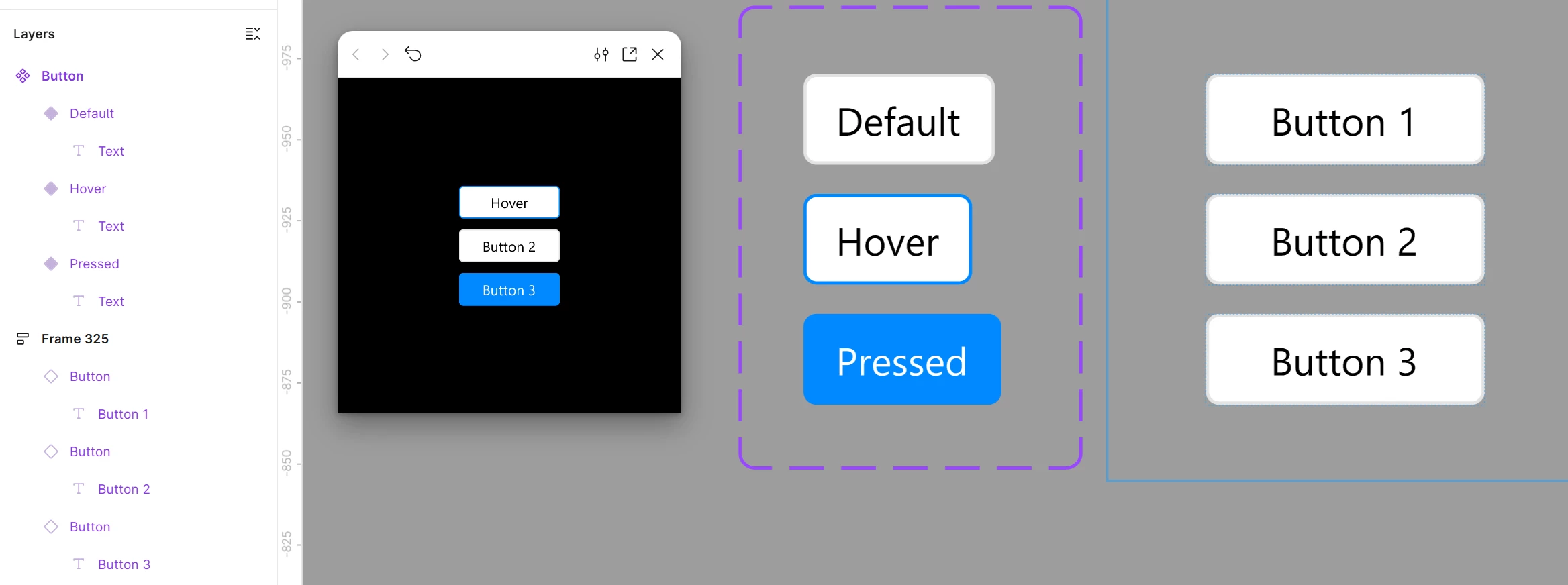

dima16
  • December 2, 2024
This is great! I reproduced this pattern in my sidebar navigation and after selecting one item it deselects other items (desired behavior), however it also changes the selected item’s label text to its default (undesired behavior).
How did you achieve the behavior when you select “Button 2” it stays “Button 2” and doesn’t change to “Hover”?
Tamara_Did_Design
Hi @dima16,
It looks like I added text property to my buttons and stored labels for my buttons in those properties.

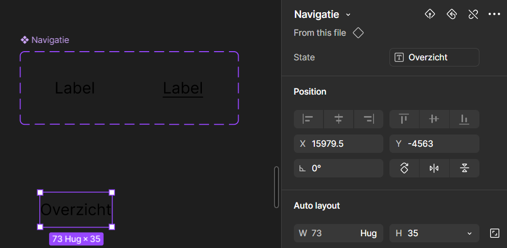

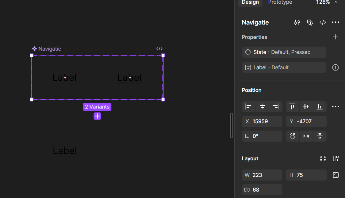

Sinzandie
  • New Member
  • April 29, 2025
Hi @dima16,
I am trying to achieve this as well but for some reason i don’t see the text property in my instance??
Does anyone know how i get to see the text property?
Daphnee Delisha
@Tamara_Did_Design
Thanks for this! I have been following along and everything appears to be functioning correctly except for button 1 which keeps reverting to its default label. The other buttons are maintaining their labels without issue. I have reviewed all settings, and there seems to be no difference between button 1 and the others. What could be the cause of this problem?
Tamara_Did_Design
@Daphnee Delisha
I’m not sure. I am not able to reproduce this… Can you describe the steps or share your file?
