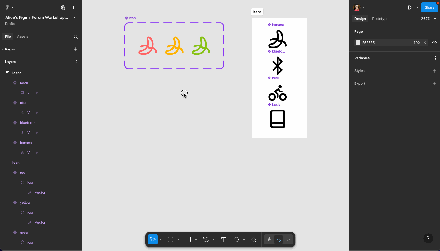

Instances of main component not respecting color configuration, must be completely reconfigured
Hi everyone!
Here is my setup:
  1. I have a main icon component that has all the sizes and the colors available.
  2. There is an instance property on the main icon component where designers can select which icon they want (basically a nested component)
  3. The nested icon component that is selected changes size and color depending on the settings of the main component
Problem:
  • We are adopting a new icon library
  • I went into the icons that already exist and replaced the .svgs
  • I created new icons
  • Now all the instances of icon are not obeying the color property set in the parent and need to manually reset and reconfigured. This is hugely manual and annoying... is there something I can do to avoid all this effort, and why is this happening?

Hey Ann! At the moment, I personally don’t have an exact set of steps I can confidently suggest 😞 BUT I asked our support team if they could advise, and they are actually interested in looking at access to your files/library and see if they can reproduce the reconfiguration problem. We’ve been working on some optimization that falls in line with the replacement flow, and this access would be super helpful.

Hey ​@Ann_Beaver! Thanks for the detailed description. I can picture your set up, but just to be sure I’ve got it correct, I’ve re-created it here. Can you confirm I’ve replicated the set up you described?
If I’ve got the set up correct, I wanted to ask some clarifying questions:

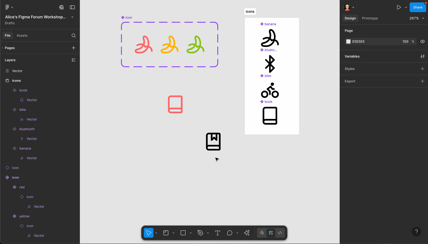

^ Do you mean that you only replaced the SVG path within the main component frame? If so, you probably experienced something like this. Here’s an example where I’m updating the icon artwork for the “book” icon component:
Correct me if I’m misunderstanding!
But if I’ve got it right, I don’t know of a way to preserve the color override without using a plugin :(  I will keep thinking about this and come back with a reply if I think of something, test it out, and see success.
​@Gleb, is there a way that your Master Plugin can be used here?

​@Ann_Beaver, I tried using the Master Plugin to get around this issue, but couldn't make it work.
I suspect the issue is that there's something on the backend with layer node-IDs causing you to lose your color overrides. If you could somehow transform your existing SVG paths to look like the new ones (potentially adding and removing nodes on the path) then that could work. If a plugin does not exist that can make that kind of transformation, you could try making your own with Figma Make?
