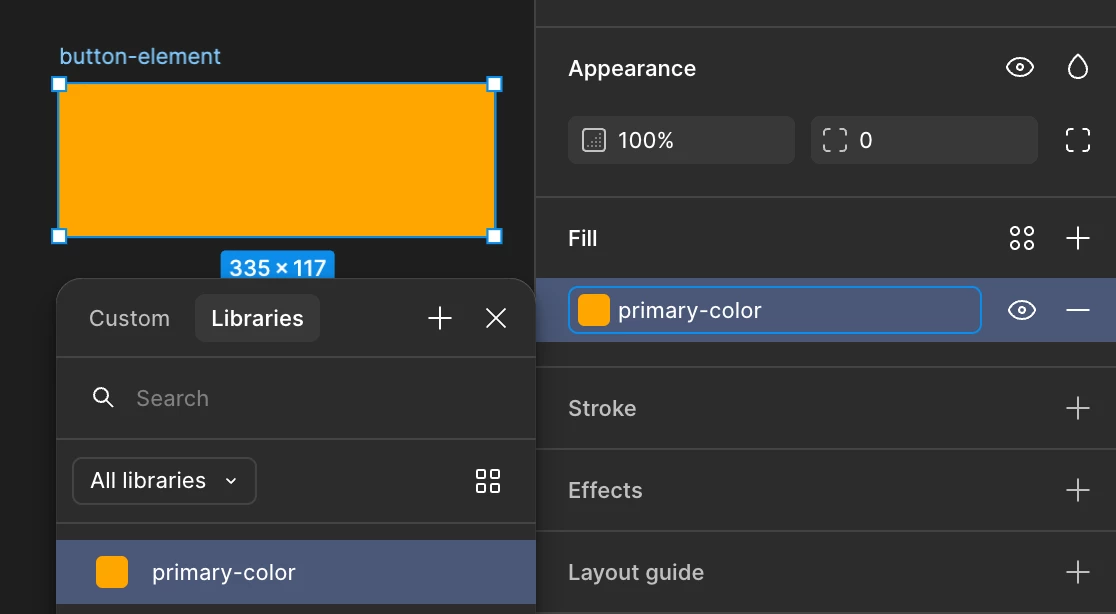

You create variables for the entire file (can also publish them), but you can apply them to individual layers/frames/objects as you wish!
For a comparison to CSS/HTML:
:root { --primary-color: #FFA500; )
Figma analog: variable called primary-color
  button-element { background-color: var(--primary-color)
Figma analog: primary-color variable applied to Fill property on an object
