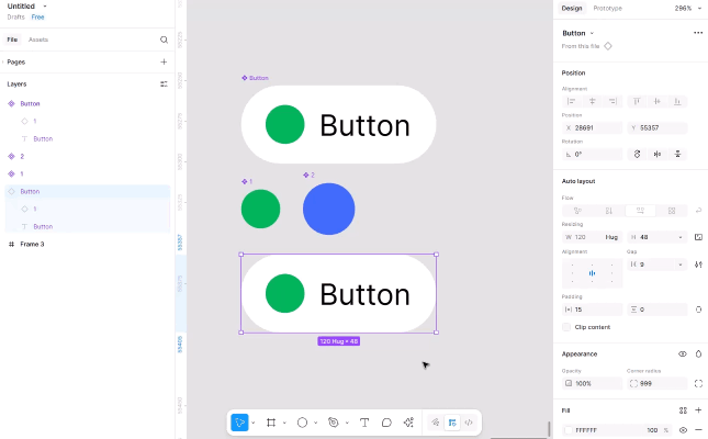

You need to apply auto layout with hug&hug settings to each icon. Here is an example ↓

Thank you Nellya! Perfect!!
