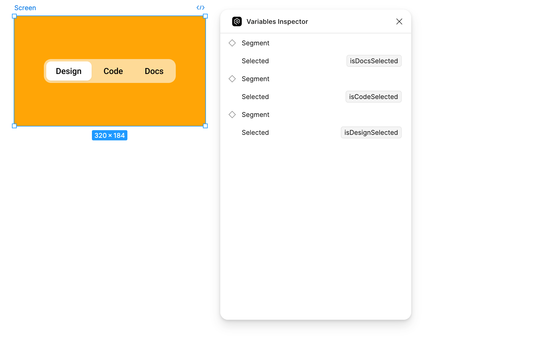

Seems like that does not exist today, not in the same way we can view/inspect regular styles.
I found this plugin that lists the variables based on a selection, not sure if this helps, but was the closest that I got.
