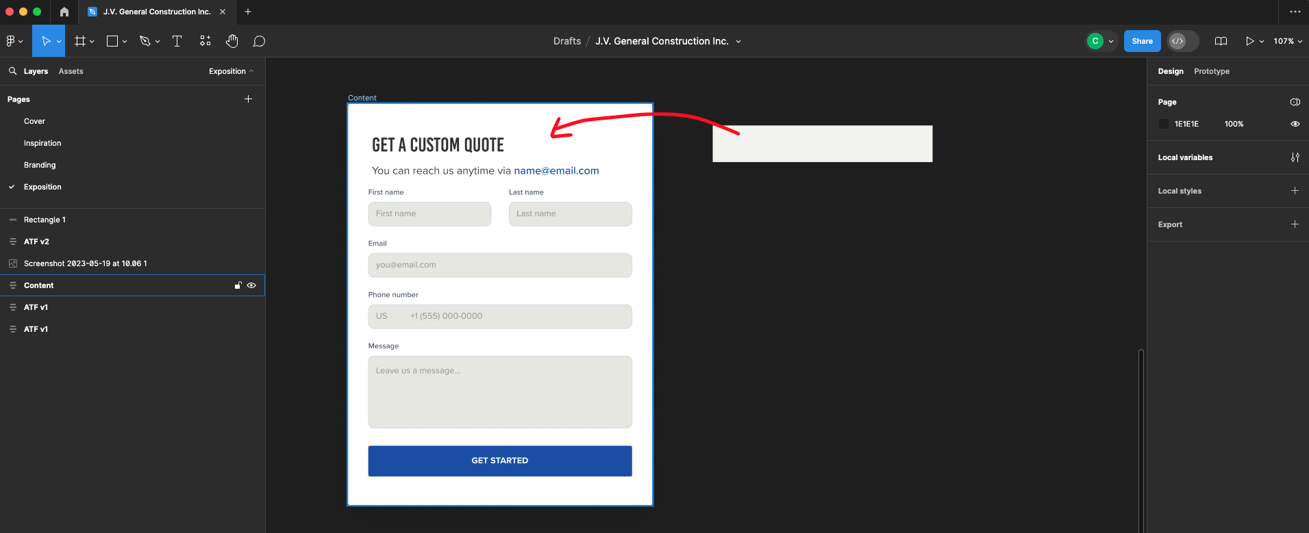

How to effectively put a separate background layer in auto-layout for header of a form box
I’m trying to put this gray “rectangle” background in the header of this form in Figma (right box). The container is set in auto layout already but every time I put in this gray rectangle, it treats it as another object and messes up the layout. I’ve also tried putting a fill behind the text box, but it doesn’t completely fill up the container because there’s padding (of 32 px right/left). Was wondering if you guys have run into this before and have a solution? 🤔

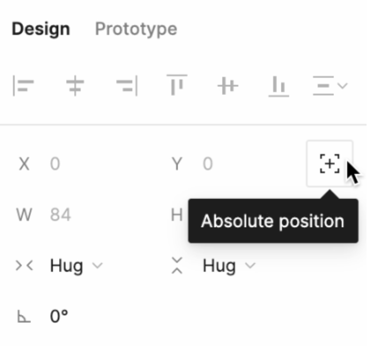

Hi @Cristine
Once the grey rectangle is in the auto layout frame, give it an absolute position (as shown below) and you’ll be able to place it anywhere you want regarding of the auto layout constraints – you might need to change its position in the treeview from leftpanel so it does not display above your form
Hope it helped
