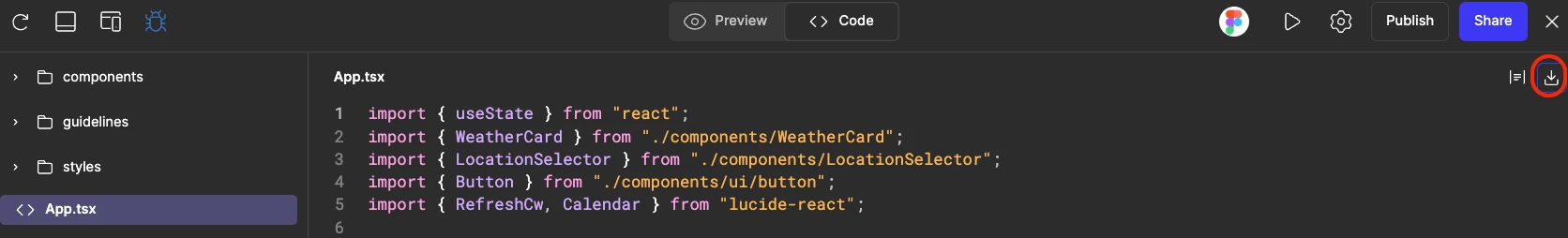

    Hey there! You can export locally by using the Download code option, located below the Share button in Code view (that should be what you’re looking for)! Hope this helps!
