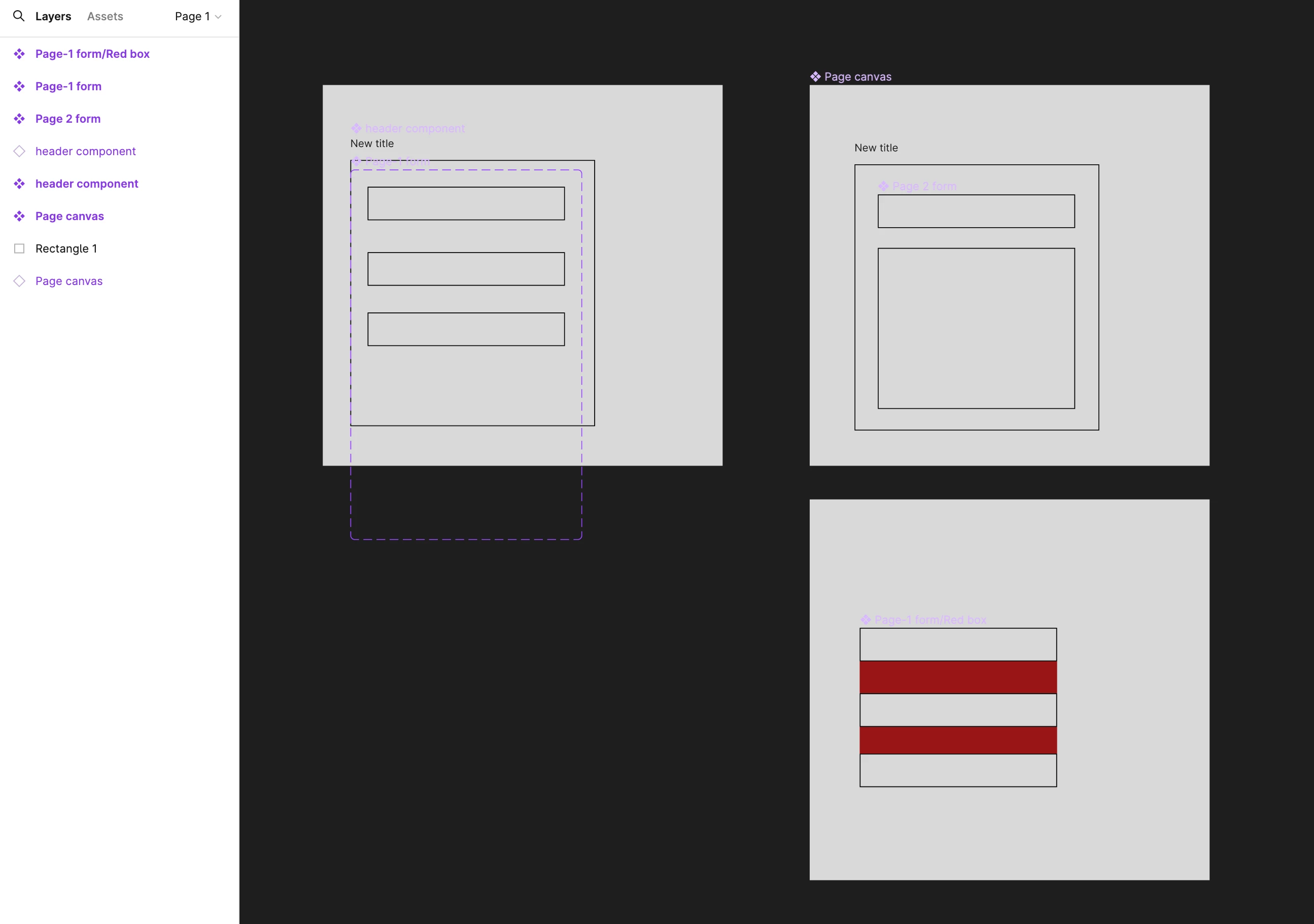

I’ve created a simple example to illustrate the question. In this figure, there are two pages, Page-1 and Page-2.
Both have the same text “Section title” below which the details of the section change because it is a multi-step interaction. (It’s a contrived mock to illustrate the point)
Now I want to change the text content of “Section title” to “Some new title” for example. Or let’s say I want to move the “Section title” by 10px to the right in page-1.
My question - I don’t want to manually apply the changes to Page-2. Is there a way to just change in Page-1 and have it propagate to Page-2 as well?

There is no way to do that. Only would be possible by writing a custom plugin.

What if I turn the 1st thing into a component? Then I can just update the component and it will reflect everywhere. Isn’t it?

Yes of course, but:
  1. Sections can’t be turned into components. If you replace a section with a component, components work completely different to sections, so you won’t be able to achieve anything that sections are made for.
  2. This:
This won’t be possible as changing position of a component doesn’t a affect the position of instances.

I don’t what you meant by “Section” here. In my case it was just a “text box” with value “Section title”. What I was referring to (please see the attached Figma file) it was just a rectangle.
What is a section btw? I am new to Figma, not aware of that concept.

I thought you were talking about Sections as in node type:
Figma Learn - Help Center
I thought you used rectangles in place of Sections so you can make them into components to test.
I don’t fully understand the question. It’s hard to figure out what sections you are talking about here and how you want them to behave exactly:
But yeah you can make the title or the whole thing into a component and it would update everywhere at once, that’s the purpose of components.
