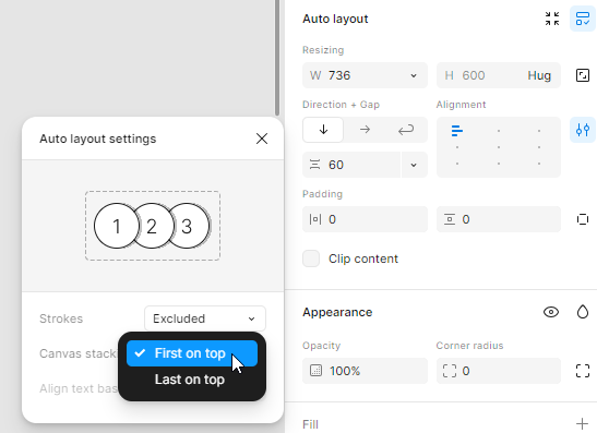

    Probably your frames are inside the auto layout. If so, change the canvas stacking

    Sounds like the tooltip is getting clipped due to auto layout or frame nesting. Even if Clip content is off, auto layout can affect stacking and z-order behavior.
    Quick fix:
    Check if your tooltip is inside a frame that's in an auto layout — if yes, try moving it outside that frame or to a higher layer in the canvas hierarchy. Also, manually adjust the canvas stacking order to ensure the tooltip is truly "on top."
    Figma can be picky with layer nesting, even if everything visually looks right.
