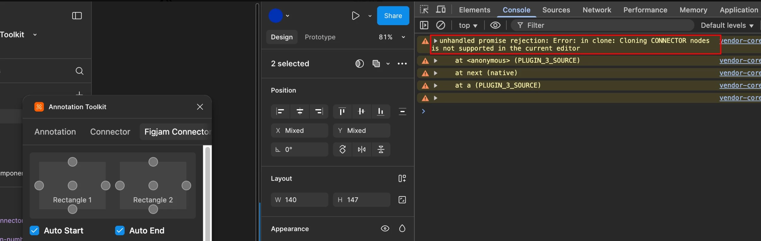

Has Figma changed or restricted its clone function API?
figma.createConnector has always been limited to FigJam.
A few years ago, I wrote a workaround plugin that allowed users to quickly clone and relink existing FigJam connectors in Figma.
However, it recently started throwing this error:
Error: in clone: Cloning CONNECTOR nodes is not supported in the current editor
I’m wondering if Figma has changed and restricted their API. Since there’s no last updated date on the API page, I’m not entirely sure. It also seems like there may no longer be any viable workaround :(
