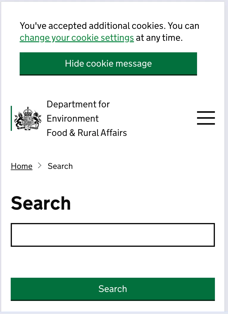

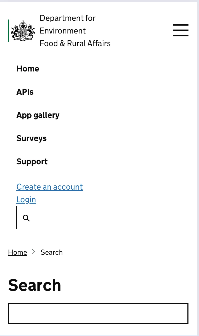

Hamburger overlay that when it expands it moves content underneath it
Hi Community, I am trying to create a hamburger menu that when it expands - opens to show page titles it moves the content - page title / breadcrumbs  down underneath it any ideas !? Included some images of the interaction I am trying to recreate…  CLOSED
OPEN

    You can simply wrap (using auto layout) all the content in order that you want and then split into 2 screens:
    1) with the menu closed (you can put opacity 0%, zero for height and check the "clip content" to make it not overlap during the animation).
    2) with the menu opened. (set height to hug and opacity to 100%)
    I've built this in this file, so you can explore it.

    Yes, it is possible with an overlay using absolute positioning for the elements that you want to be in front
