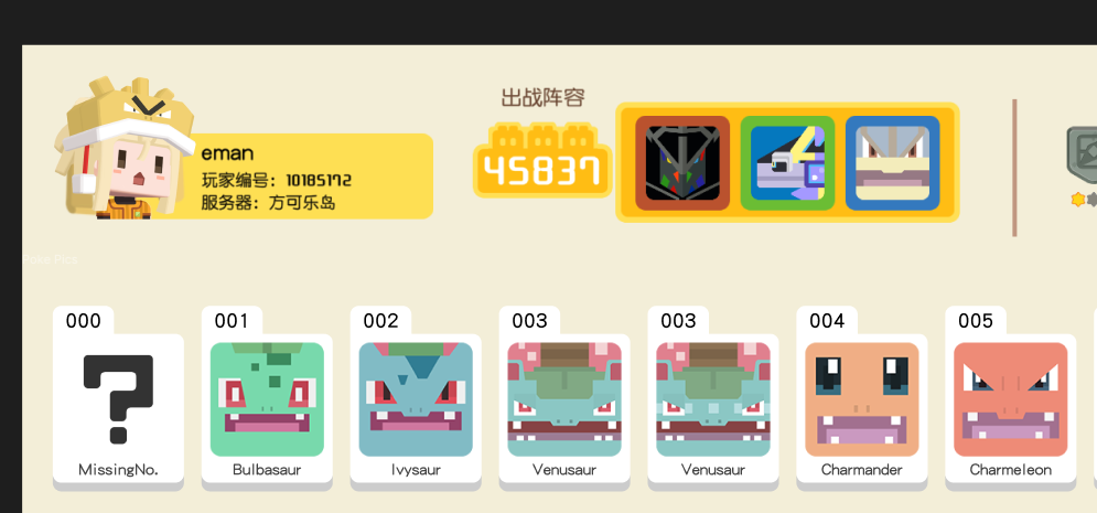

So for the Chinese Version of Pokemon quest they made this thing you could use a few months before they permanently shut down the game where you could generate a picture of the entire pokedex and which ones you did manage to get.
I’m now recreating that layout in figma to generate a high quality version of it that’s fully completed.
In the top corner it showed your player icon, which I’ve recreated here:

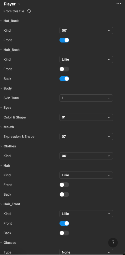

I’ve made a setup like this to allow full customization for this icon which looks like this:
There are 3 hair components since it’s split into a back, middle and front hair layer.
However for this component the Front and Back toggles should not be viewable as your not supposed to edit them here.
The same goes for the hat, though the hat is split into just 2 layers: a back shown behind the head and a front shown…… in the front
Additionaly the 3 hair components need to be set to the same variant manually but ultimately I’d like to have 1 drop-down list control all 3 of them.
Same goes for the hat.​​​
