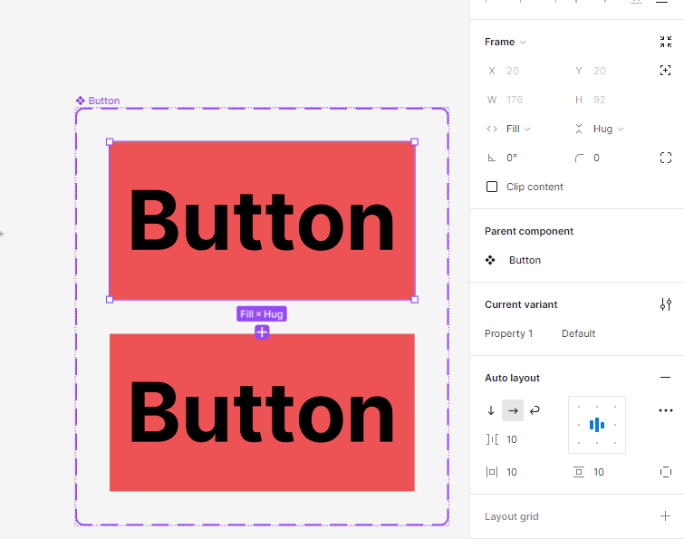

Yeah the thing is if I drop the component from the left drawer into that frame and change the variation to full width it turns to fixed.

Has anyone found a solution for this? I’m having the same issue.
My Default button variant is set to hug and I want a second Mobile button variant that should be set to fill width. Dragging in the Mobile button variant into an auto-layout with fixed width it works and the button fills the entire width of the auto-layout. But if I first drag in the Default button variant and switch to my Mobile button variant it changes to fixed width and has the same width as my main component.
