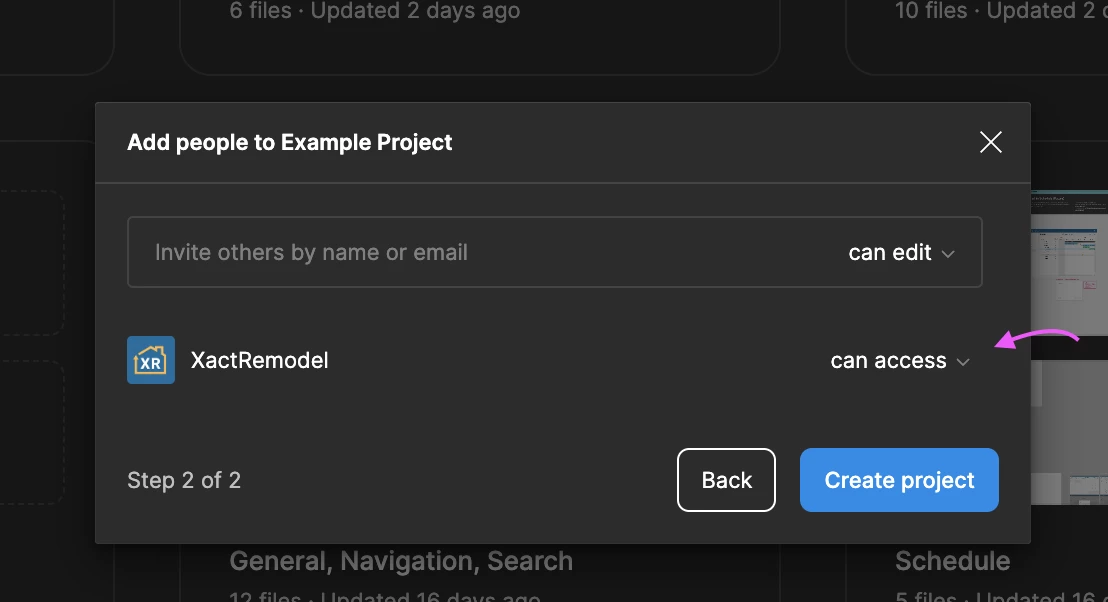

I may have solved my own problem. During the Create project dialog, on step 2 of 2, where it says “Add people to ”, there’s a control for access rights at the team level with two options, “Can access” and “Can view”. It appears in every situation when Admin and members with Can edit rights are unable to edit, this is set to “Can view”.
Changing the team access to “Can access” appears to have resolved the issue.
For those who have already created a project, this access setting control is also available in the Share project dialog!
