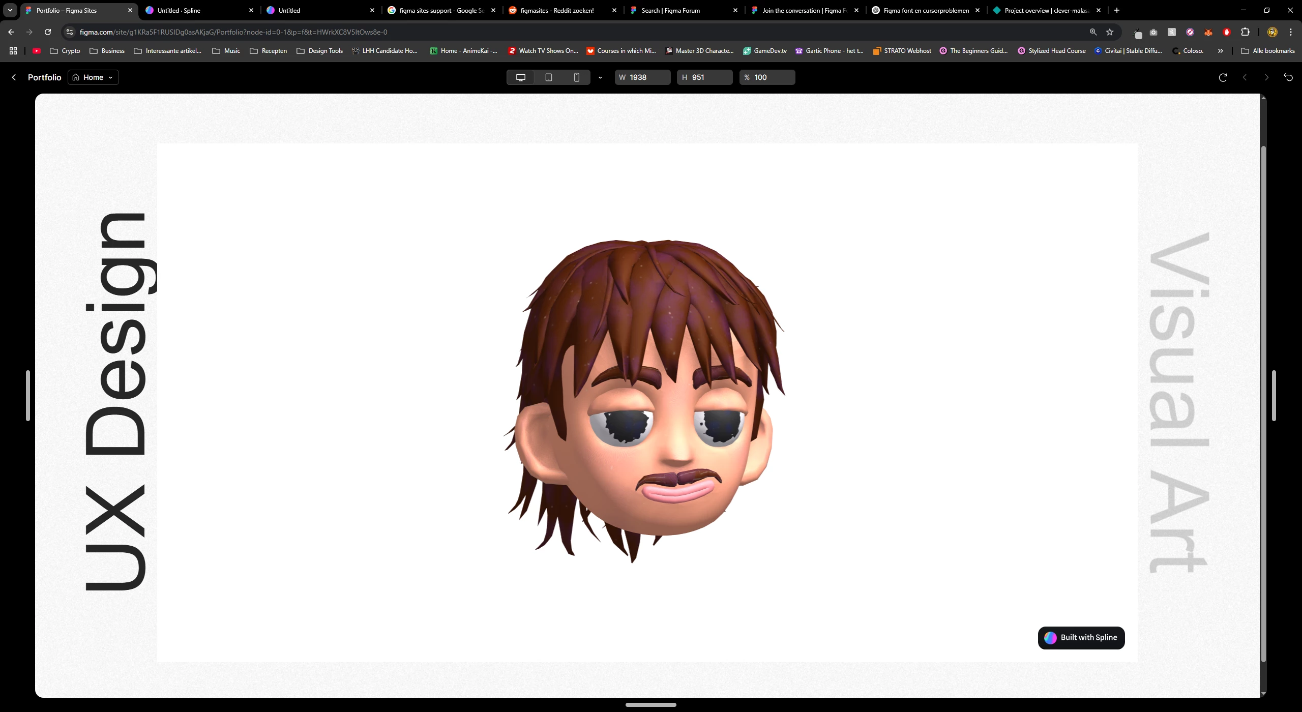

Issues in Figma Sites iframe:
  1. A white background appears, despite the canvas and scene alpha being set to transparent.
  2. The Spline watermark is still visible, even though it's turned off in export.
  3. Visual effects (like glow, hue shift, pixelation etc.) don’t show at all.
  4. Even when using the correct embed code or hosting the scene manually with spline.runtime.js, Figma Sites seems to render a limited or outdated version.
  5. Changing the URL, clearing cache (Ctrl+Shift+R) or using versioned URLs doesn’t update the embed rendering.
  6. Hosting the scene on Netlify does work flawlessly, except for the lookat event, so the issue is specific to the way Figma Sites embeds and displays iframes.

Figma sites version
