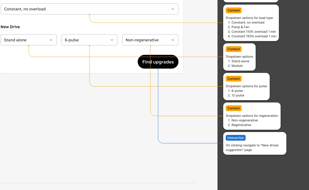

Hi,
I have configured the Figma MCP setup in my VSCode and tried to get the annotations data for a figma screen. The screen has many annotated components and I did code connect for the components as well. No matter which ever prompt I try, I’m not getting the annotated values. The prompts run get_metadata and get_code of the MCP server but still I get no desired results
See the below figma screen
Screen
What should be the correct prompt or way I can extract all the annotations for the figma screen url and store it in a file?

It’s correct. Infact I’m able to get the code (ReactJS) and design tokens for the screen. Its the annotations that I’m not getting.

​@Homi , I struggled with this issue too.  See my response to another question below.  Basically, I needed to ask Cursor’s LLM to call get_design_context and show me all of the data, to see what the annotations data were named.  Then tell Cursor to search for those data explicitly.
