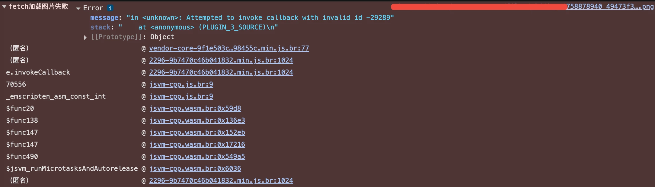

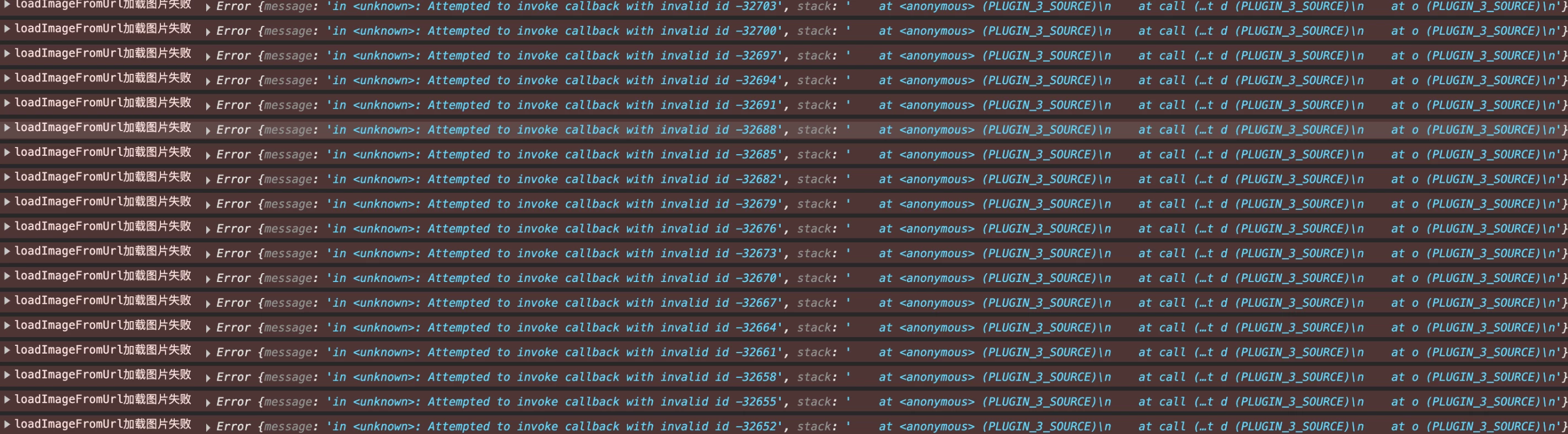

I encountered an odd problem about using “figma.createImage” to create a image hash. I have 3000+ image urls, I want to fetch image data, then convert to image hash  to display. When an error occurs, the console shows: "in :<unknow> Attempted to invoke callback with invalid id -xxxx". Are there any limitations on fetching images in Figma?
this is call stack:
It seems fine when image requests are fewer than 2,000, but ​​when they exceed 2,000​​, errors often occur.
