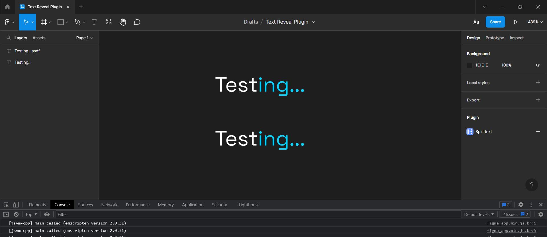

aamir.shaikh
April 14, 2023
I don’t see any error.
I am trying to get and set fills for a text node.
The reference text is “hello”, where “he” is white and “llo” is red.
When I apply the fills to the output, it is all white and not according to the reference text.

How many times do you call the setRangeFills method?
aamir.shaikh
April 14, 2023
20 times in the above case (string.length * 4)
tank666
April 14, 2023
Sorry, but you are doing something wrong. You only need to call this method 2 times. The first time to set the fill to white, the second time to set it to red.
text.setRangeFills(0, 2, [whiteFill]);
text.setRangeFills(3, 5, [redFill]);
aamir.shaikh
April 14, 2023
Sorry for the confusion.
I am calling it 2 times per Text Node. I have 2 text nodes for each letter in the string.
So, 2 x 2 x 5 = 20
tank666
April 14, 2023
At the moment, I can only suggest that you revise your code that was left behind the scenes. Or share enough code so that anyone can reproduce what you’re experiencing.
