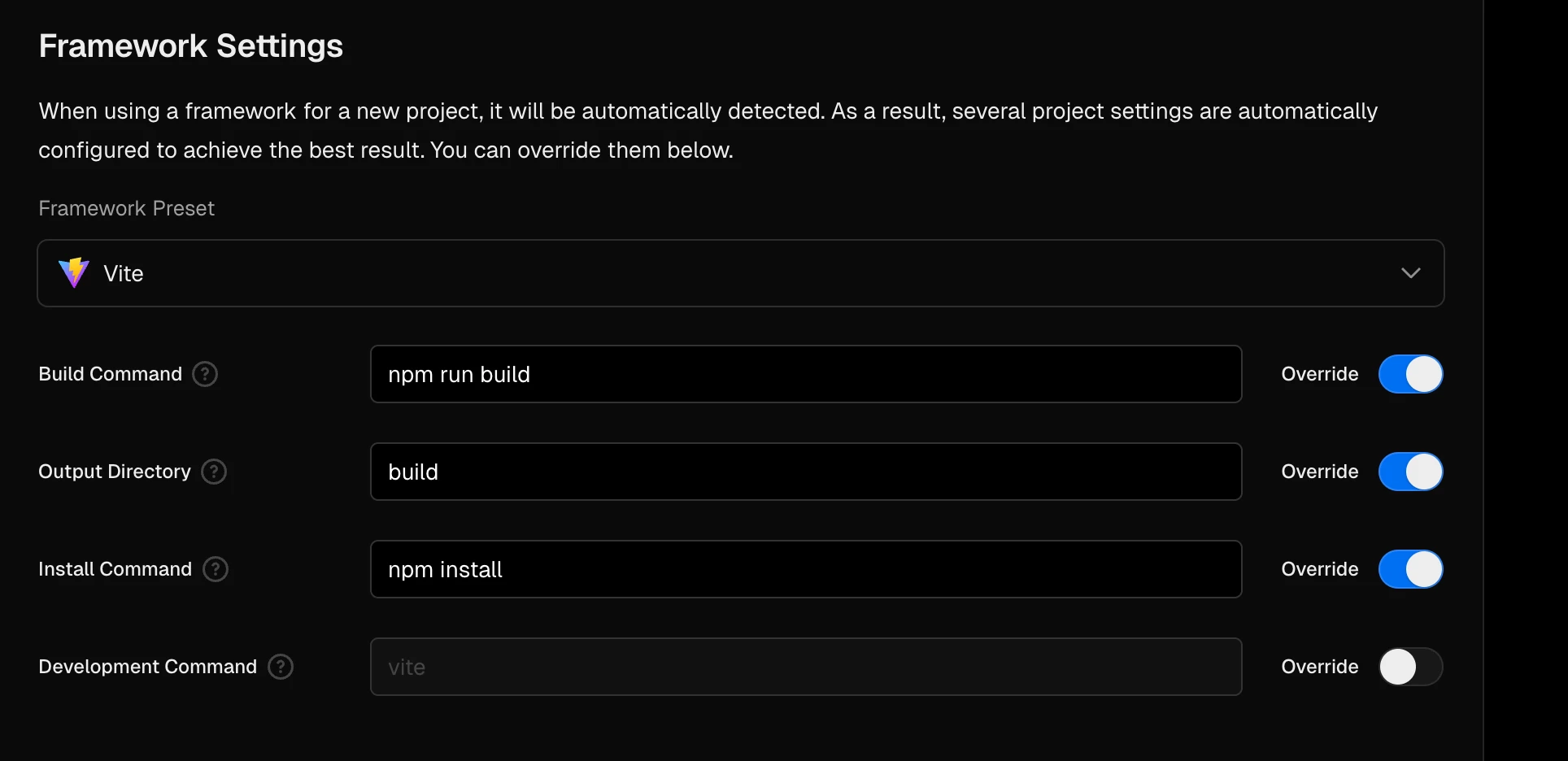

I was able to do this
  1. download source code locally
  2. Review in VS Code
  3. Import into gihub repo
  4. connect vercel to github repo
  5. run automatic deployment
I had to configure Vercel with the following settings
