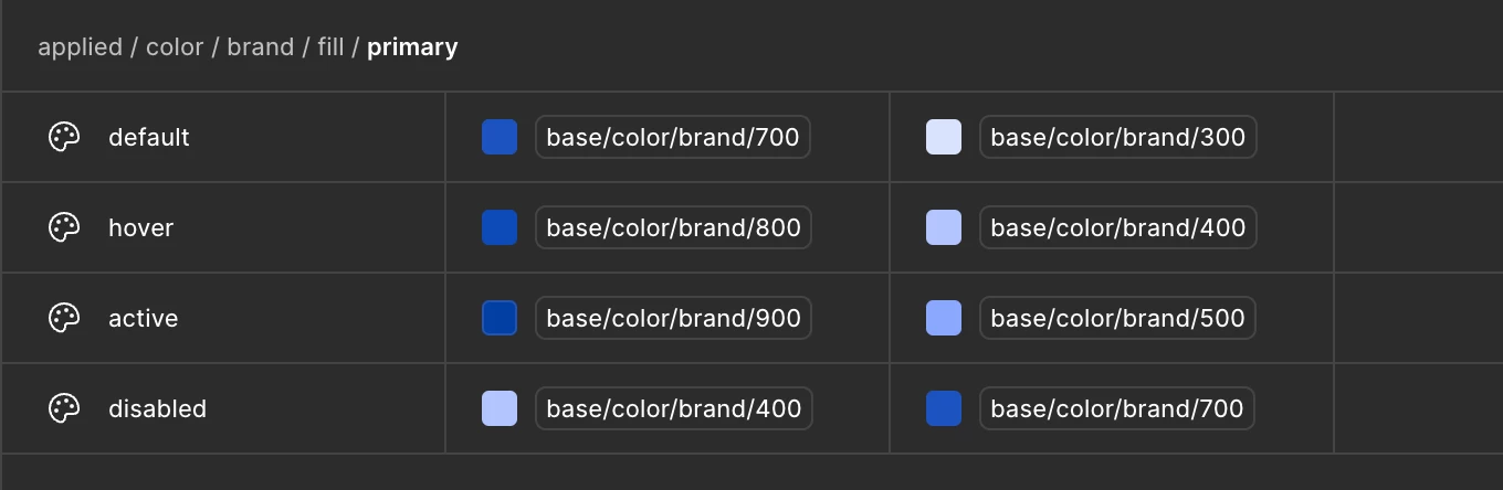

Hi, we were setting up our color variables for light and dark mode and noticed that the preview of the colors in dark mode do not represent the actual value behind it. Anyone has any idea why this happens and how to fix it?
A little backstory, we have set up core, base and applied tokens in the variables window. The base level is where we set up theming. However, in our applied level we sometimes overwrite a color for a specific token in dark mode. However, when we do this, the preview seems to show the colors as presented in light mode instead of dark mode. When we actually apply the token, it all works properly, it is just the preview in the variables window that shows the wrong color.

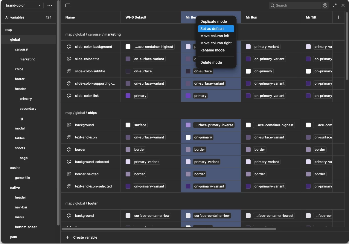

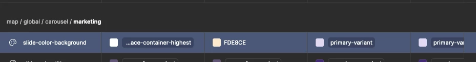

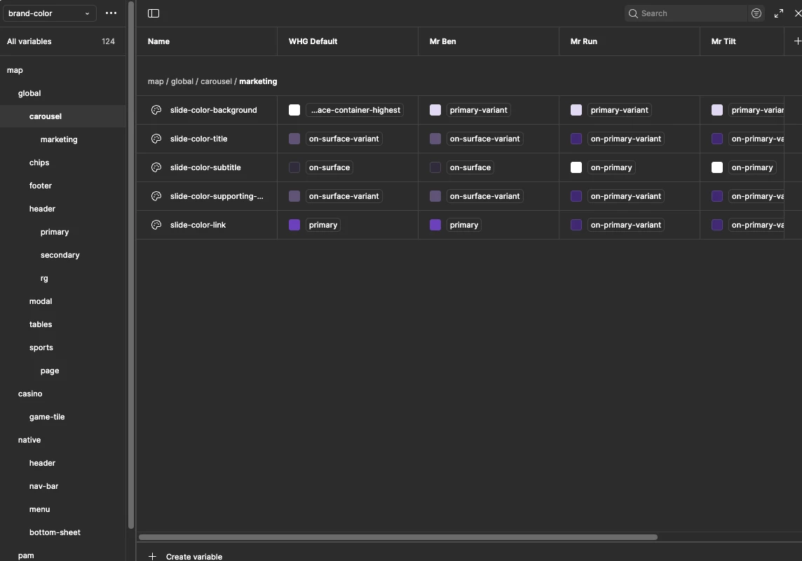

antaautumn
Oct 2, 2025 9:37 AM UTC

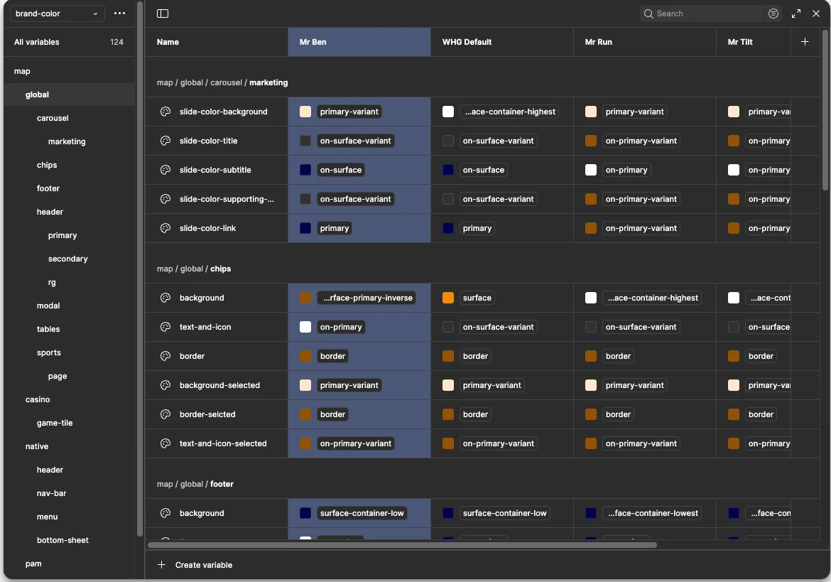

Hi, facing a similar issue, but with the swatches preview. Suddenly all modes are displaying the same swatches in the previews, yet, if you unlink them, then the correct hex value are displayed.
I am working on a white label product, so we use modes in our team with the purpose of rebranding the product per customer. Mode switching works well for now, but it is very difficult for the team to actually design.
It seems that all modes switch to the default colour, because the 1st mode is the default (purple). If I switch the second mode to default, then the colour swatches change to orange.

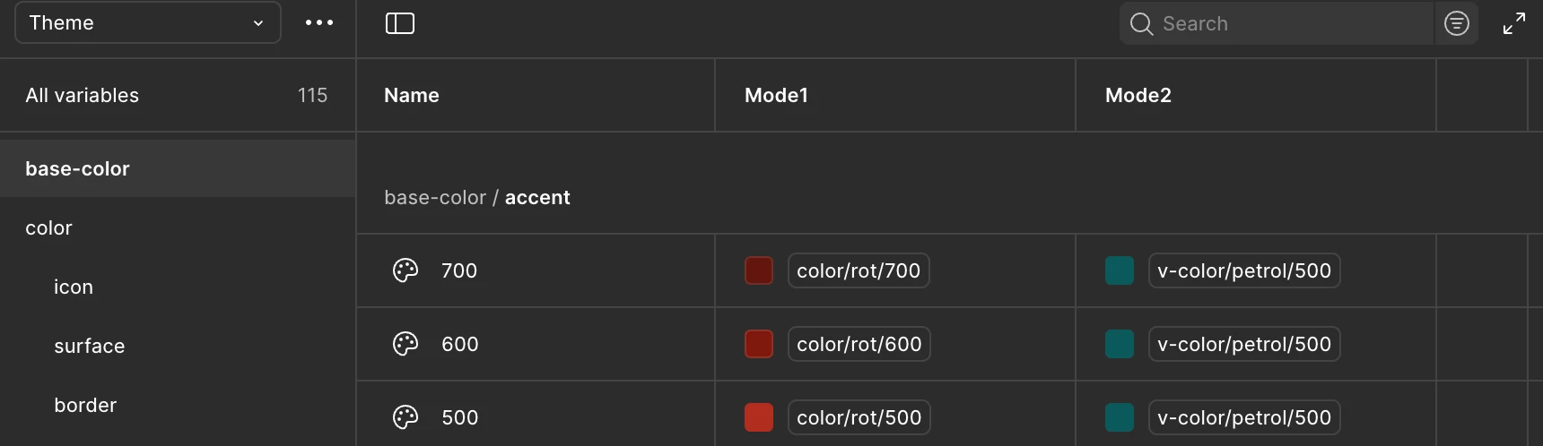

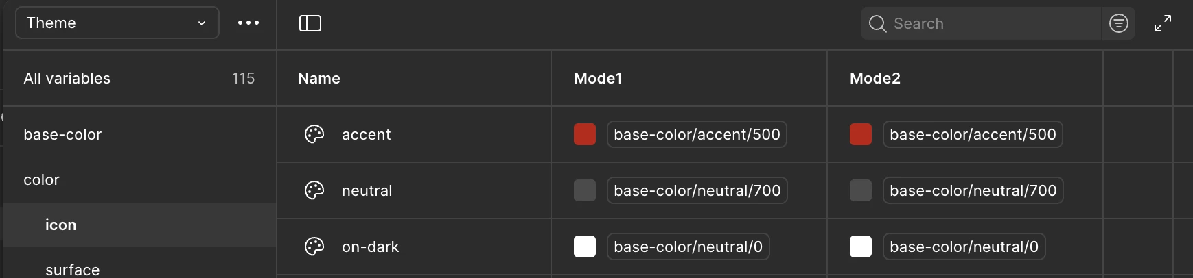

Rebekka_Zorn
Oct 13, 2025 9:52 AM UTC
Hello everyone,
I am having the same Problem.
This makes working with modi really hard. Please have a look at this:
Base color mapping
icon color Mode2 shows mode1 color
Thank you very much
