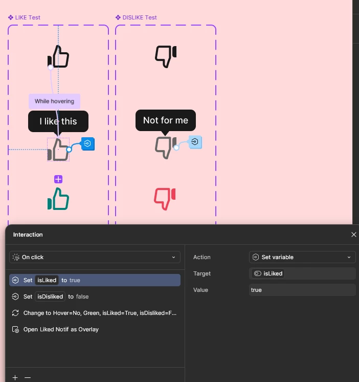

Below is the current logic I am trying for the “like” button (I’ve tried a few variations, I’ve asked AI, and I’ve tried different variables. I’ve also tried having both buttons in the same component set).

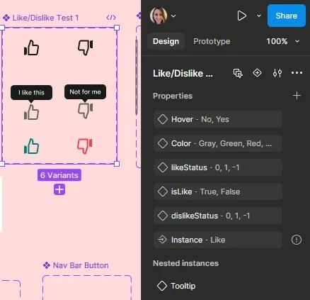

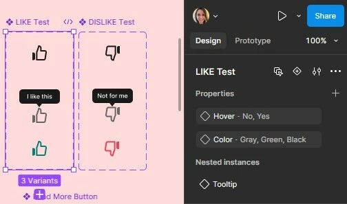

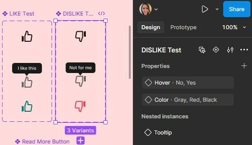

Hi Raphael - Below shows the current props of the separated components, as well as the option that contains both like/dislike button in a set.

    Create 2 variables that would control the active state of the like and dislike button and then use conditional logic for the actions.
