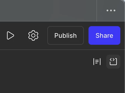

I spotted the "Download Code" option in the upper right corner of the editor, but I noticed that there is no "package.json" file. Is there any documentation or a way to run these projects locally using my own IDE?
