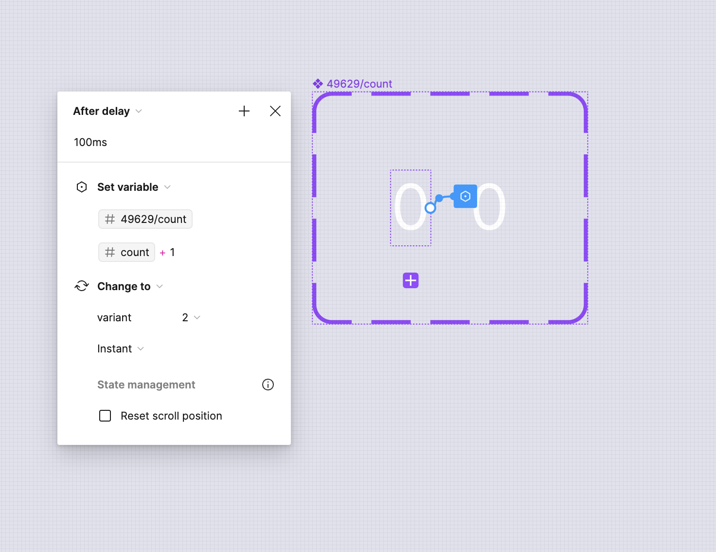

Counter component
This one is simple, it has two state witch are the same
  1. Create a text layer
  2. assign the count variable to it.
  3. Then go to the interaction panel (Shift+E) and add a new after delay interaction (I put a delay of 100ms that will defined the speed of the count growing)
  4. set the variable count to count + 1
  5. add a change to action and set it up to go to the other variant
  6. repeat from 1 to 5 for the other variant
Having two similar variant is a tricks to connect the component to each other and force the count variable to update

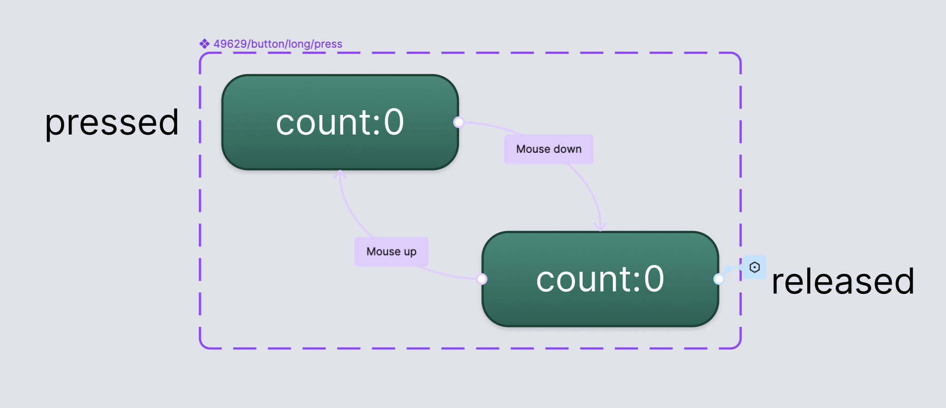

Button component
The button need to have two states pressed and released :
  • The pressed one as two text layers in it and … that’s it
  • The released one as one text layers and an instance of the counter component (previously defined above)

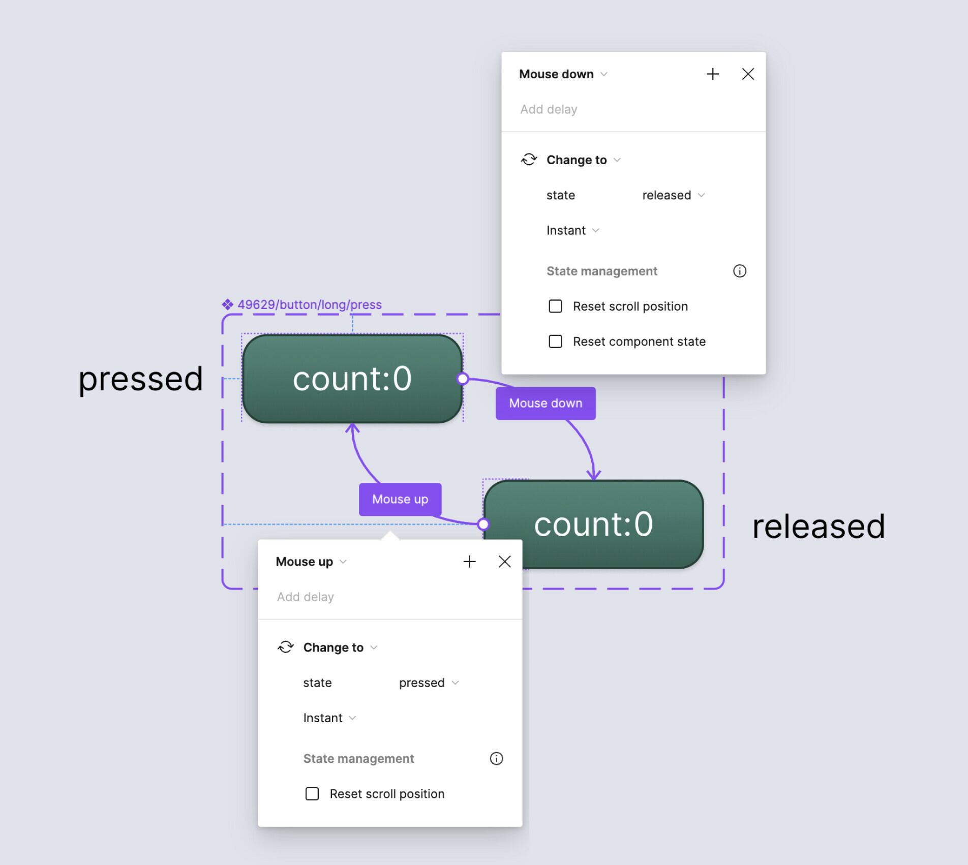

    The interaction between those two states are really simple :
  • pressedreleased : add a “mouse down” interaction
  • releasedpressed : add a “mouse up” interaction
and that’s it.
Now you have a component that will goes up continually when pressed and stop when released.

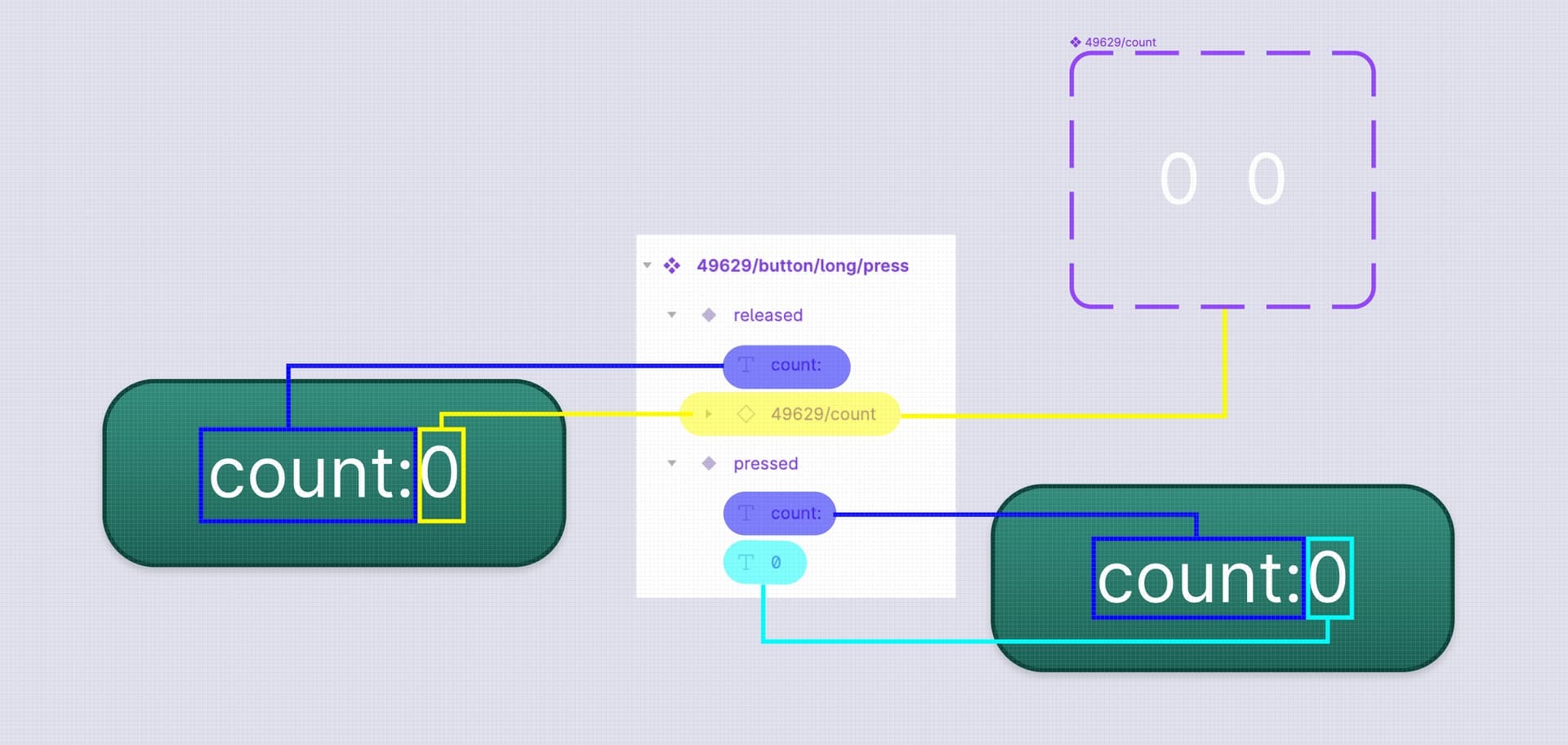

Hey @Zhao_Yang
This is the breakdown of the component’ structure
Here is the breakdown of the component’s logic
I cannot gave you access to this file since it’s protected, so let me know if this help, otherwise I’ll make a new file
