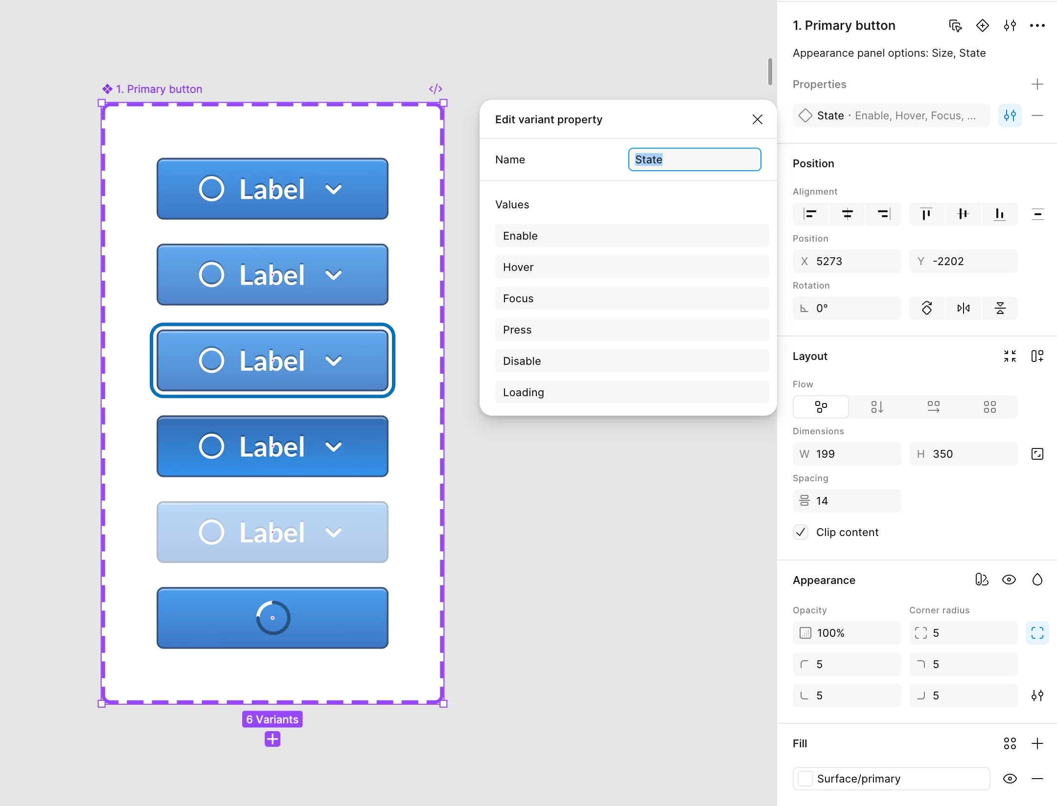

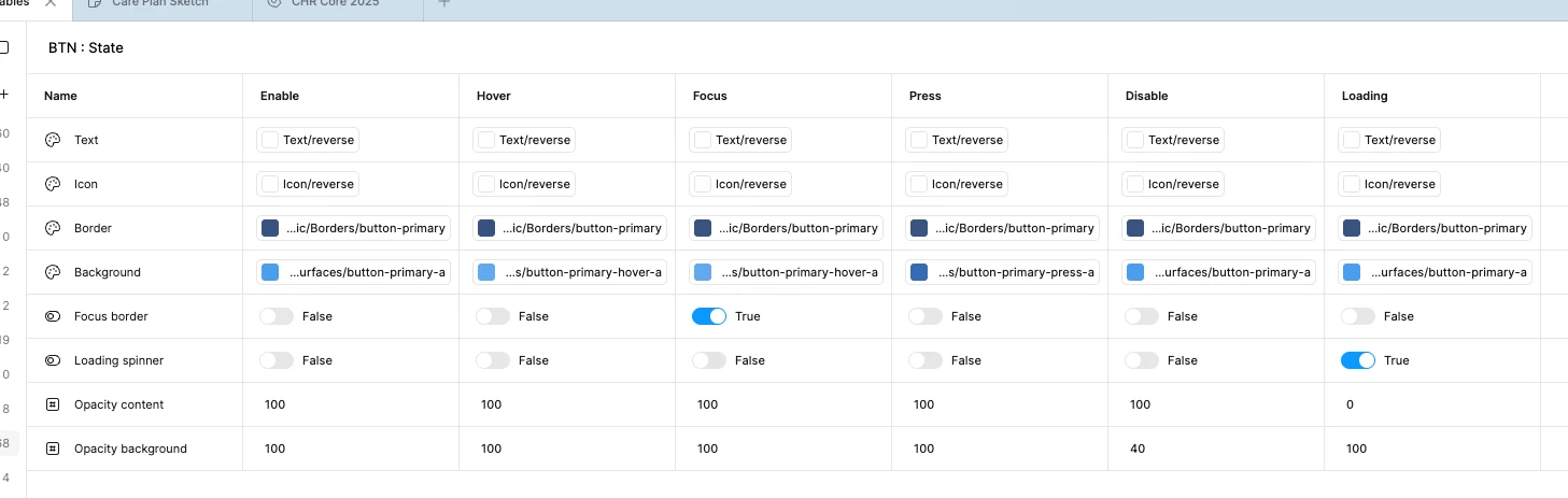

Below example showing how ‘State’ can be managed as variants or variables, but this could be extrapolated multiple times within a single component to manage more options. E.g. Button types (primary, secondary, tertiary, etc.), Button sizes (large, medium, small, etc.), etc.
1. Variants approach
2. Variables approach
