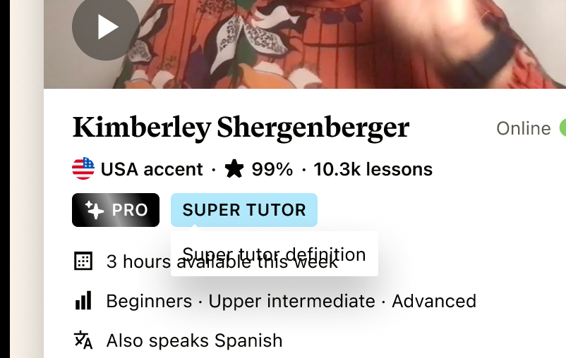

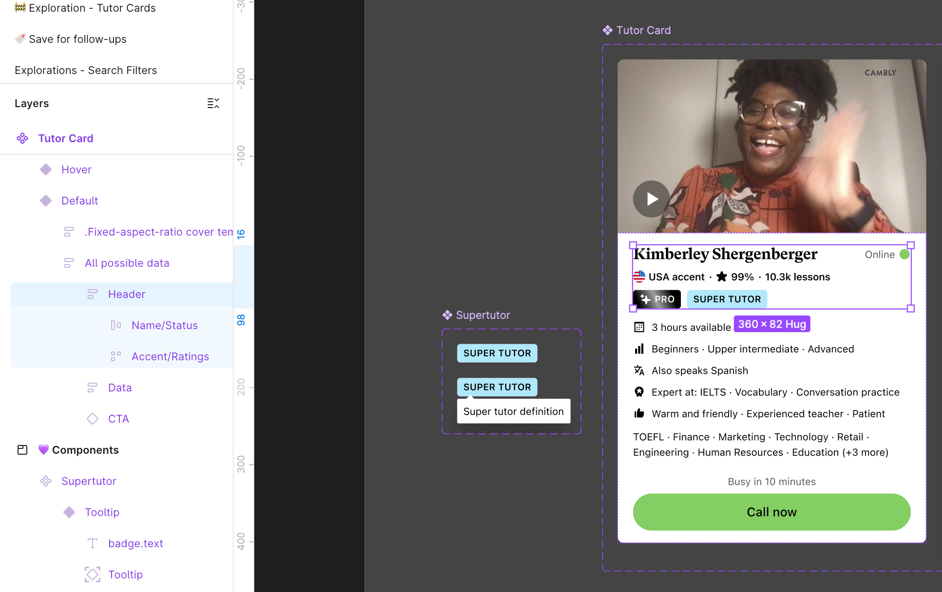

So I have this tooltip component set to show on the “super tutor” tag when hovered over in this card (located in “Header”, in the prototype it shows the tooltip behind the content in the “Data” layer. If I hit “move to front,” the Header section is at the bottom of the card

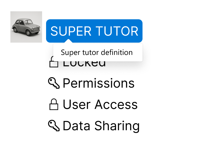

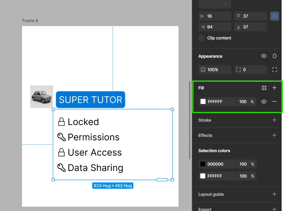

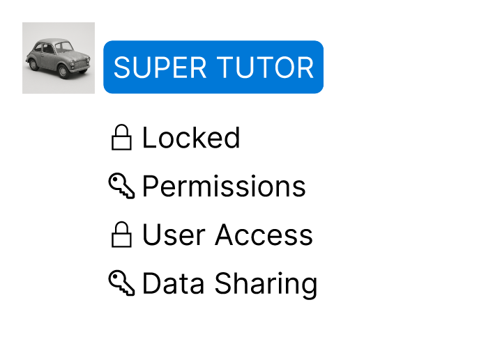

I had a similar issue and what helped was adding a white background fill under the "Data" layer. That way, the tooltip doesn't appear behind the content. Maybe that could work in your case too?
Attached a few screenshots showing the setup I used.
 Background
Default - Prototype
Hover - Prototype
Hope this helps!
