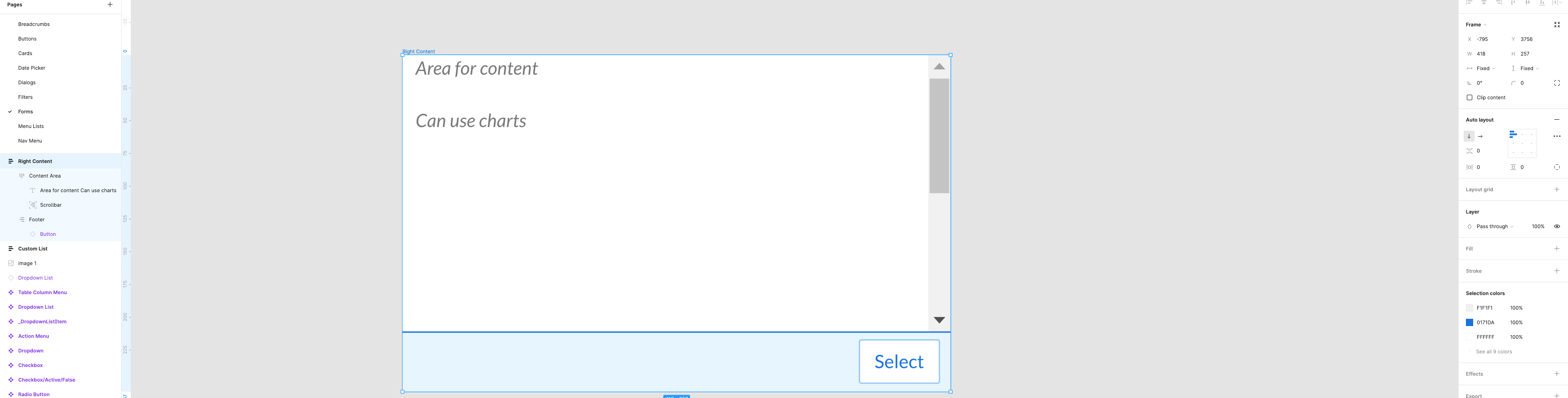

Can someone help in choosing the properties for this component I’m working on?
I need the scroll bar and Footer button to be responsive when I resize.

Hi @Ramanand_Sreenath,
Regarding your scrollbar and looking at your composition on the left panel:
Content Area should probably have a height set at Fill, and since you choose to put your Scrollbar with an absolute position: its vertical constraint should be Top and bottom (to match it’s parent height).
As for the footer, you may wanna provide some more details about the intended behavior for it’s not clear what you are currently expecting.
