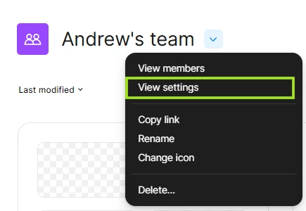

    Yes, it is possible to add a library so it automatically appears in every design file within a specific team. You can do this by enabling the library in the team settings.

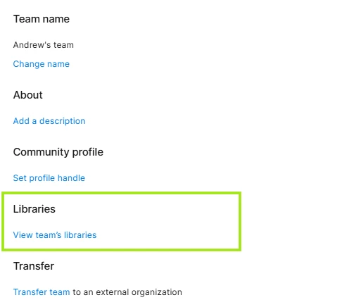

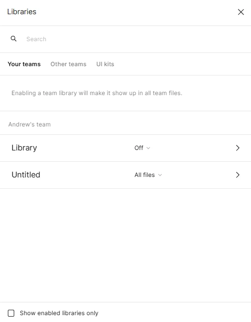

    Just go to the team → open the menu → select “View settings” → and under “Libraries,” you can activate the ones you need. After that, the library will be available in all files across that team.
    Open View settings
    Open View team’s libraries
    Select Library
