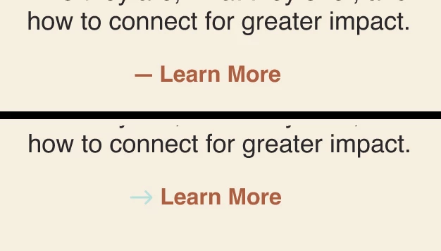

Anytime I use a variant with overrides applied the interactive component causes the variant to revert to its default state in the prototype.
I may be doing something wrong, but it feels like a bug.

I did an experiment where I removed the instance of a nesting component that contained the button which worked to get the different states of my buttons, but the content (icon + label) kept changing to the initial state, ignoring the overrides.

I am having the same issue. I am creating an interactive sidebar, and my components have an icon and a title in them. The hover states work fine, but I also have an enabled state with an override that is not working. The enabled state will hold the changes to the copy, but not the icon that I want to change out. When clicking the enabled state will show my icon reverted to the default icon.
