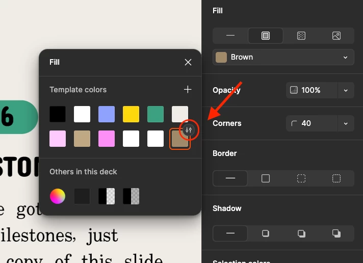

Hey - looks like I’m having the same issues regarding deleting, renaming or changing the colour styles in Figma Slides.
I have a colour that I created that is not being applied anywhere in my deck. I can see it when I go to apply a style in a page in design editor mode, though it is not there in the Custom Style editor and so there is no ability to edit or delete it here.
I’m looking to either change the colour for the colour variable or, delete the colour variable so that I can create a new one with the new colour.
Apr 29, 2025 5:29 PM UTC
Hey Julia,
Thanks for flagging this! Sorry to hear you're running into trouble managing your color styles in Figma Slides.
Just a heads-up — I checked and saw that you’ve already reached out to our support team (your support ticket is #1320624). The agent has responded with some details to clarify the issue you're seeing, so I’d recommend checking your support ticket when you get a chance.
Please also continue the conversation with the support for further assistance, your ticket will re-open automatically.
For anyone else encountering a similar issue with renaming colors in Figma Slides, I wanted to share some general insights our team uncovered through Julia’s report that may be helpful for the community here:

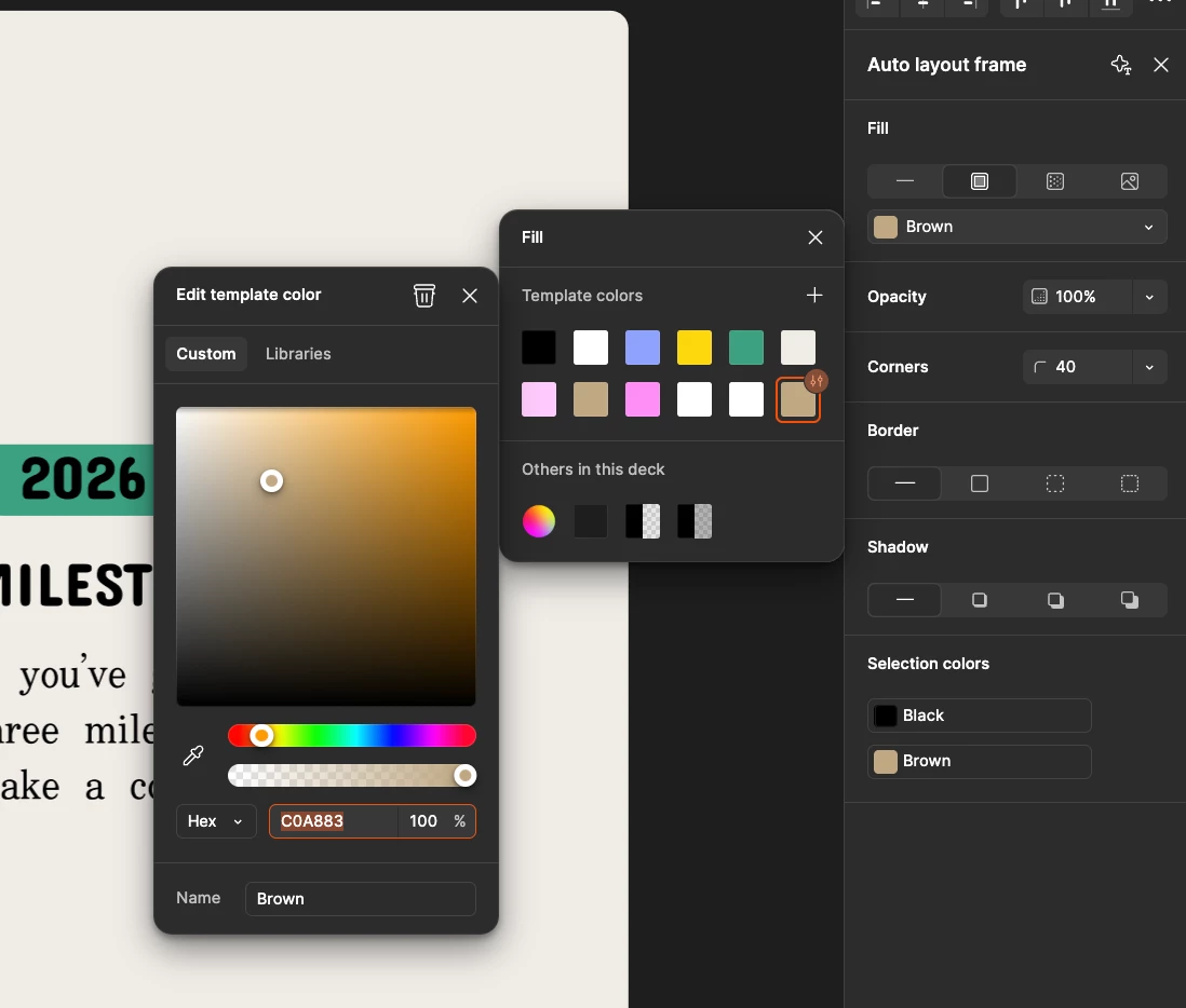

  • For example, when you click on a color style (see screenshot below per example, I edit with a brown color), it will replace the currently selected color in your template with that one. To change the actual color value itself, you’ll need to use the “Edit template color” option.

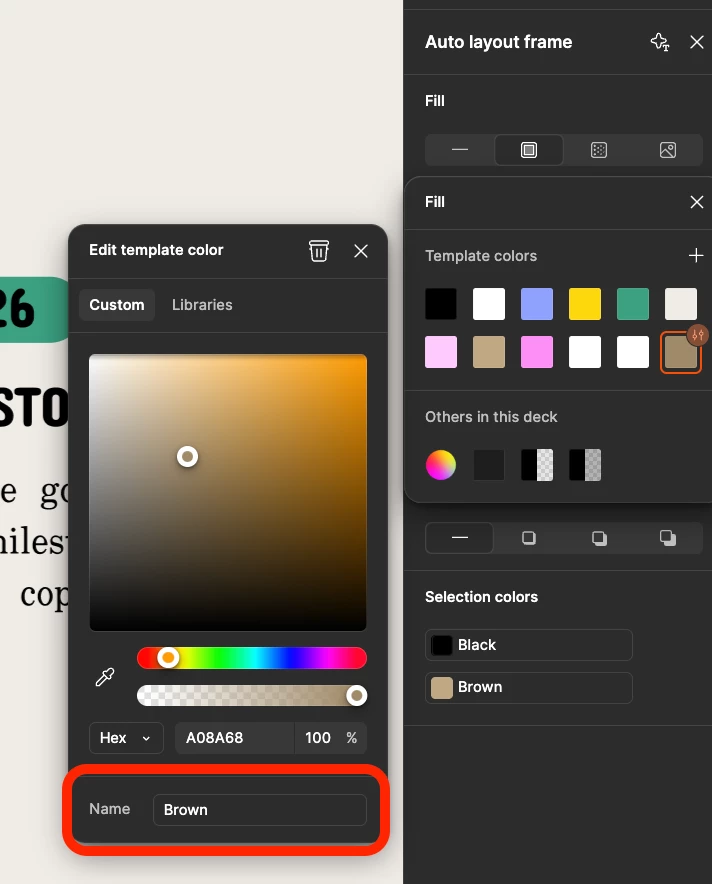

  • If you want to rename the color instead, you’ll want to go to the “Custom” tab (where your selected color appears), and then update the name from the field at the bottom of that modal.
  • You can also open the “Edit color” modal by clicking on the slider icon. Same thing applies here. The "Custom" tab lets you adjust the selected color and the "Libraries" tab allows you to replace it with a color from your libraries (including other libraries, if needed).
