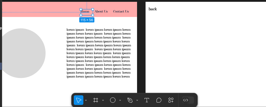

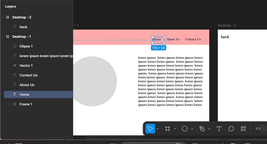

Krisha123
Feb 5, 2025 11:17 AM UTC
plus icon is not showing when i select the text!, i want to coonect the home page to myactual home page that is in another frame naming “desktop”.
