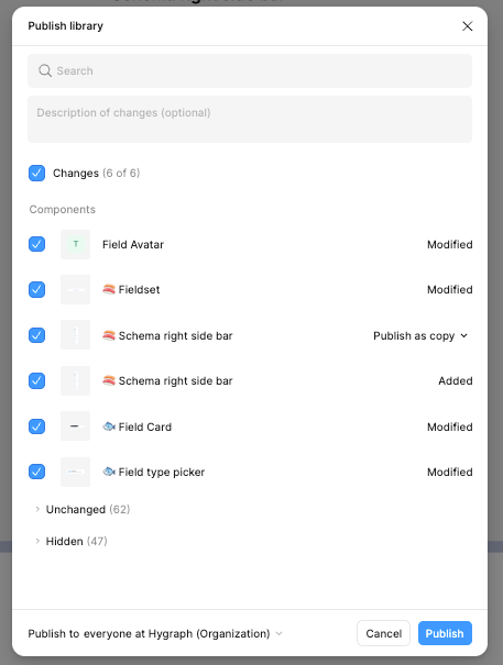

Now, when I’m wanting to publish the master component from File B, I always see “Publish as copy” next to the component, along with a greyed out “Move to this file” option.
The problem:
File A no longer exists and this component is not a “copy” of any component. How can I get rid of this prompt? It makes me nervous, as if there’s some ghost component somewhere that I have no control over, and the “Publish as copy” language is confusing.

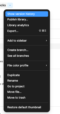

So this is the solution
1.  Go to version history and find the original component
2. Paste in the original component so it has two master component, one of them you want to replace and remove. In my case it’s The “🍣 Schema Right side bar”
DO NOT PUBLISH HERE (merely showing this as an example)

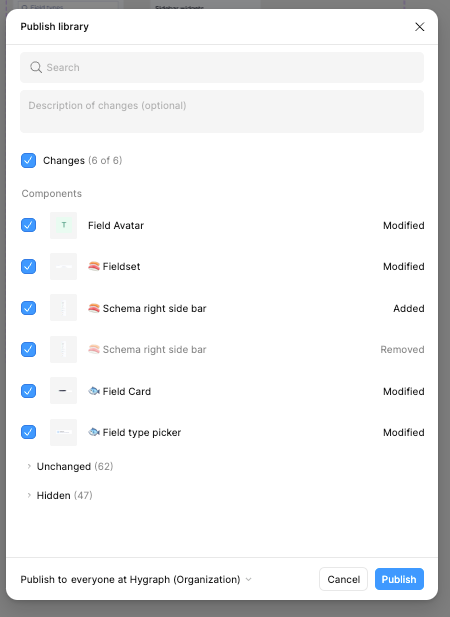

3. Delete the wrong one from your file (the one that says “publish as copy” ) Then when you press publish, it’ll say removed.
4.  Go ahead and publish.

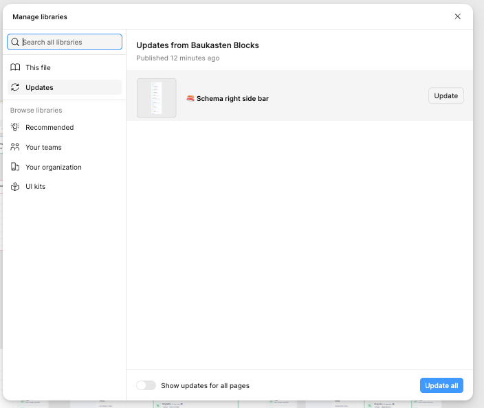

5. Update the component with this newly published library in your other files

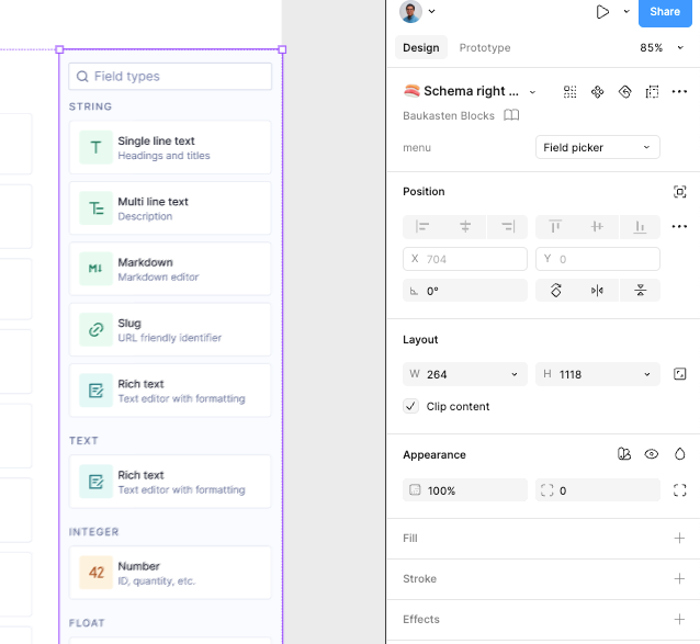

All master component has a unique ID, so if the one from your version history is properly connected then it would say update, your component would be restored and connected properly.

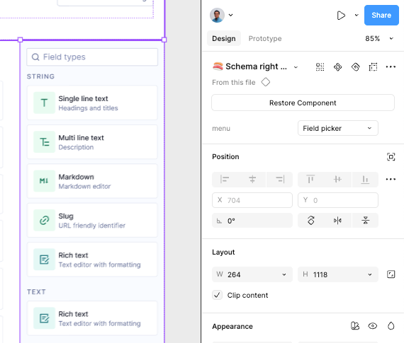

However, some of your components might be connected to the wrong/ duplicated master component that has just been removed.
These components would say “Restore” when you select the component. It means they are connected to the removed master component.

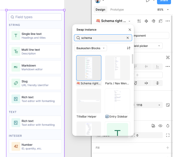

7. You’ll have to reconnect them to the component by replacing it with the correct one from the library by selecting it in the dropdown.
8. If all the Properties in the components are exactly the same between the updated one and the outdated component. Your components will retain the props and will NOT be reseted.
