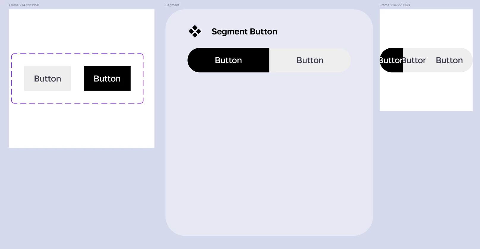

Hi,
I don’t know if I’m the only one with this problem.
I have the slot. I configure it, etc. everything awesome.
I take the instance, try to use it.
Add an instance of the component that I had selected as the preferred one.
Now, it breaks my Fill for width and height for the component and the component doesn’t fill the slot area!
Now, I know it has to be changed to fill but weren’t slots supposed to be automatic? So that whatever is put there, it behaves like it should?
WTF?
Another BROKEN FEATURE… OMFG.

We are also experiencing this issue. We have some components set to fill container within their component frame. When inserting those components into a slot, they add as a fixed width instead of filling the slot container like expected. This behavior adds an extra step that our designers need to do to properly use those components as they are coded.
However, if I drag an instance directly from the main component into the slot, then it respects the fill container and it works great. It doesn’t respect the fill when inserting from the “+” button on the slot or the quick insert menu.

@Straton_Roberts has exactly the problem although I am not really able to drag and drop stuff as my component having the slot gets “crazy” - it doesn’t insert into the slot, it inserts the item wherever it wants…
IMO there should either be a switch for a slot “preserve added instances features” or something… or it should respect them just like that, IMO this is expected.
