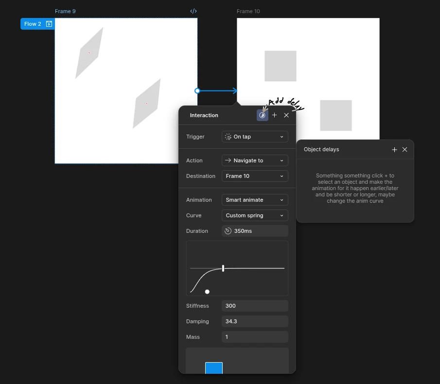

pinuaple
May 5, 2026 4:15 PM UTC
Something like this would be cool
