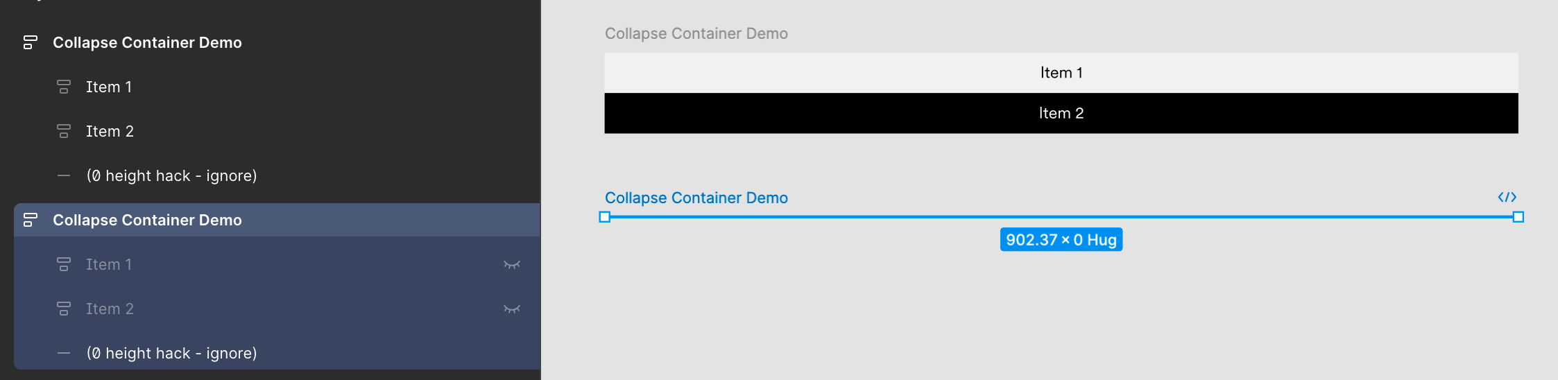

Hi folks, You can solve this with a little hack – I think its been mentioned here in this post, but I didn’t see a screengrab, so here it is:
  1. In Figma, you can set an element to have 0 height (I don’t think this was always the case, but you can do it now).
  2. However, an autolayout container has problems collapsing to 0 height, when it is emptied of elements - it does better when it has a containing element to set its height from, even if that element is 0 pixels high.
  3. Hence the fix is to put in 0-height stroke that will always be at the bottom of your stack. The Container will now reliably collapse to 0px height when all items are hidden inside it.
0 height quick hack
0 height quick hack
I tried this hack but the issue is that the stroke counts as an item so a gap will be created between it and the other elements which will then ruin the size of the frame 😅 so it only works if the frame has 0 gap.
