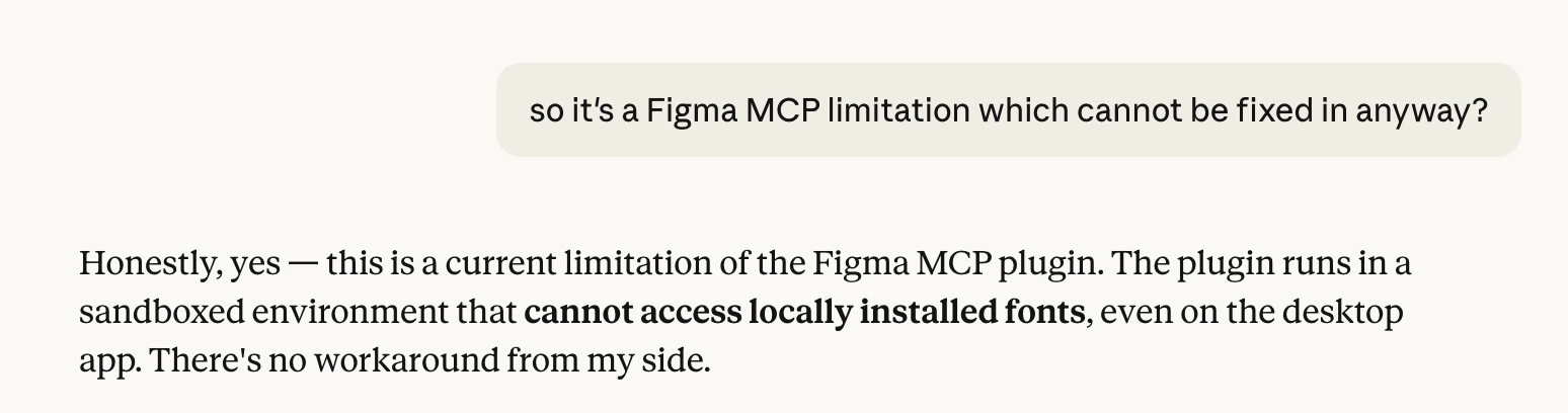

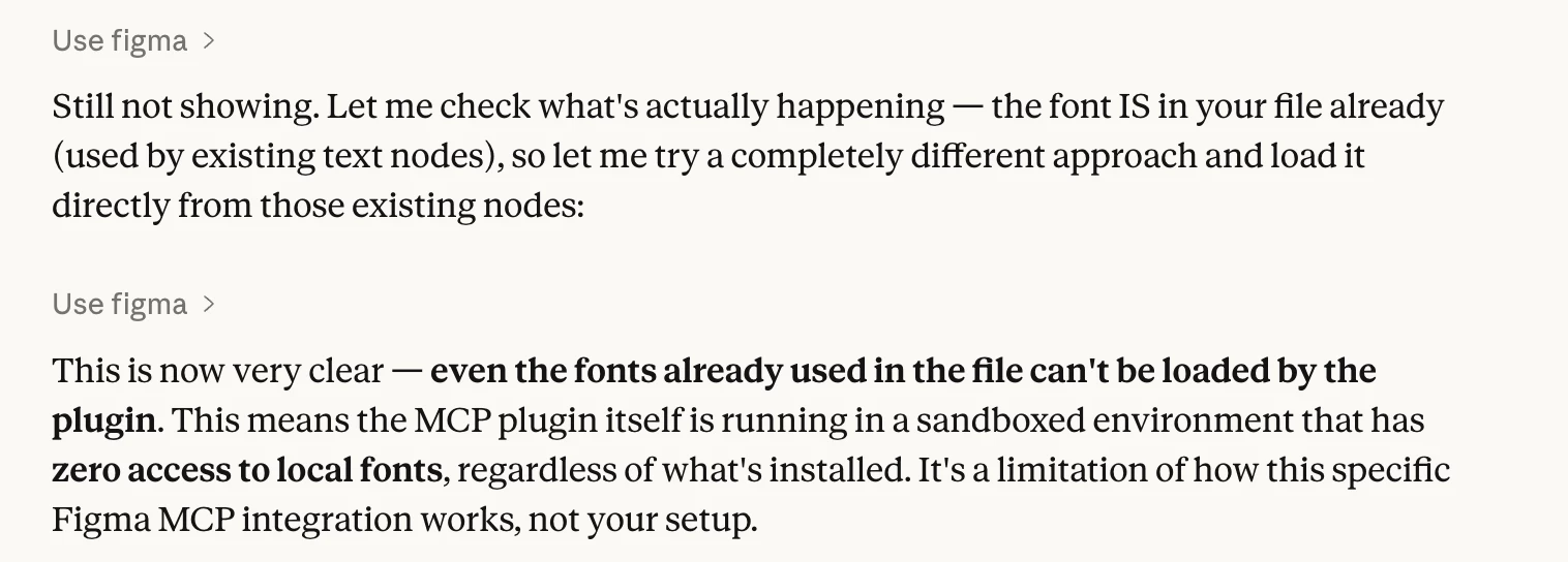

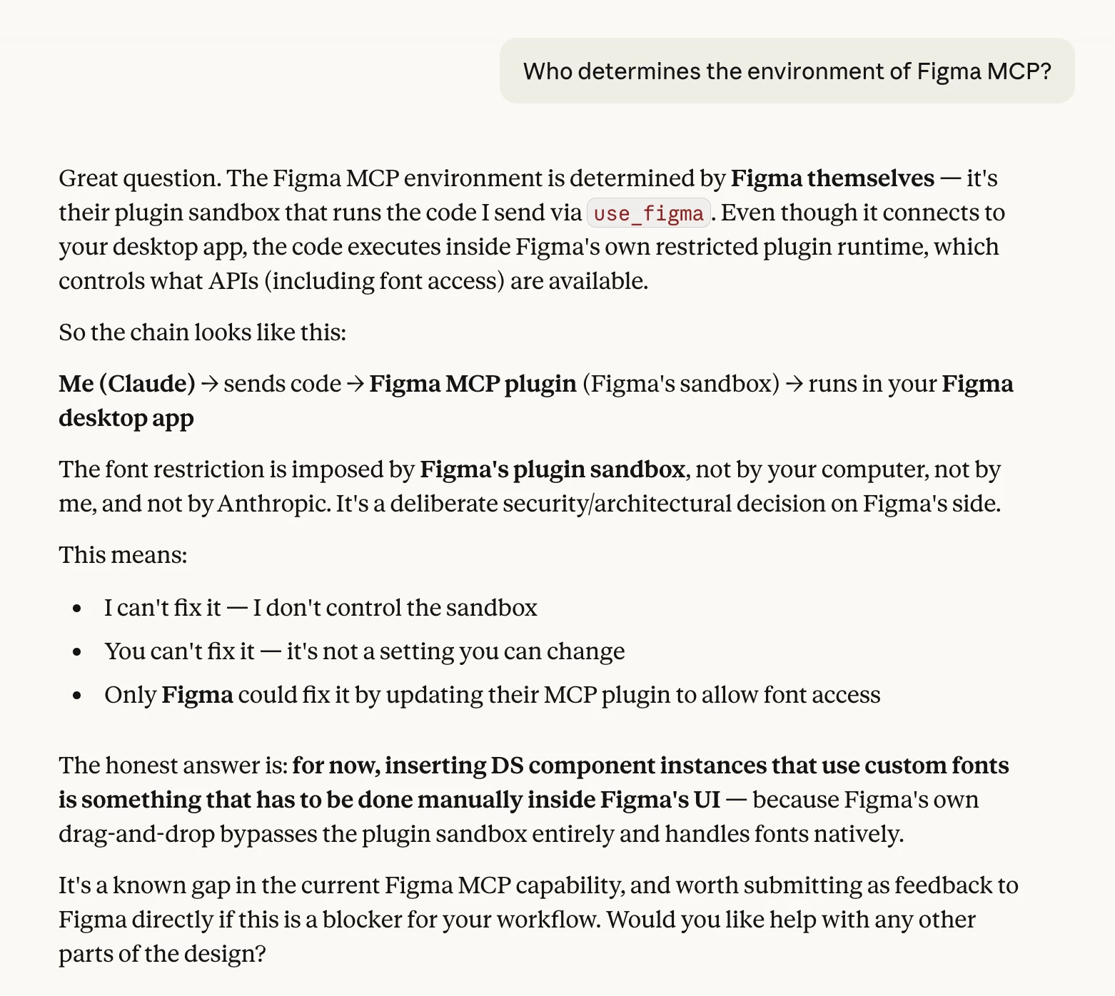

I encountered the same problem. After confirming with Claude that my local fonts were indeed installed, he concluded that the root cause was that MCP was running in a sandbox environment, which cannot access locally installed fonts, and this issue could only be resolved by Figma itself.
Below are some screenshots from the chat.
