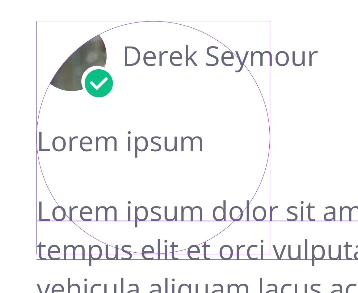

We have an Icon Library in our design system, as well as a separate glyph library. These icons are used in different sizes across the product (16px, 24px, etc.). The master components of each icon and glyph contain elements which are all set to ‘scale’.
However, within our larger components, whenever we want to swap an instance of an icon with a different one from our library, the scaling (of dimensions, stroke width, and border radius) is not properly applied, resulting in a broken view.
One example is:
  • We have a nested icon component scaled to 16x16px;
  • We replace the instance with another icon from either library (original component of which is 24x24 but all elements set to scale) and expect it to scale properly to the 16x16 dimensions. However, the swapped icon appears broken in terms of the scale of elements inside, stroke width and border radius;
  • We have to resort to a workaround like: 1) Detaching from the master components, 2) Resetting the icon to its original size, 3) Scaling it again to the desired size. Which works for now but it’s frustrating we can no longer make use of the flexibility of the overall component’s properties.

Hi everyone! Just wanted to share a quick update here for visibility in case others are running into something similar.
​@Julien Blanchet, I saw that our technical specialist were able to take a closer look at your report. Here’s what they found:
This is a known issue we’re actively tracking: right now, when swapping nested instances, the scale factor isn’t being applied correctly. While the fix may take some time, here are some solutions that can help in the meantime:
  • Instead of using scale, try applying size overrides directly to the nested instances. As you mentioned, another way to have it work is to set auto layout on every variant, and detaching the instance causing the issue.
  • For the icon width specifically, we recommend having auto layout set to “hug” for all variants in your component set. Here's a video showing what that looks like in your example.
Thanks again for flagging this, and we really appreciate everyone’s patience as we work on a more permanent fix 🙏🏼
