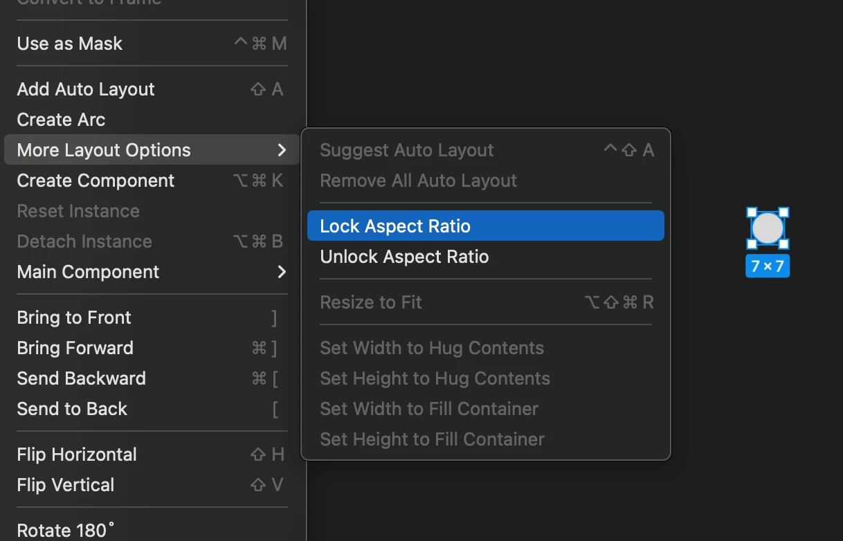

DM0
Nov 14, 2025 5:09 PM UTC
Shouldn’t this menu item be a single item showing either ‘Lock...’ or ‘Unlock...’ since it’s a boolean?
*Also and maybe more importantly can we have a shortcut to toggle this?
