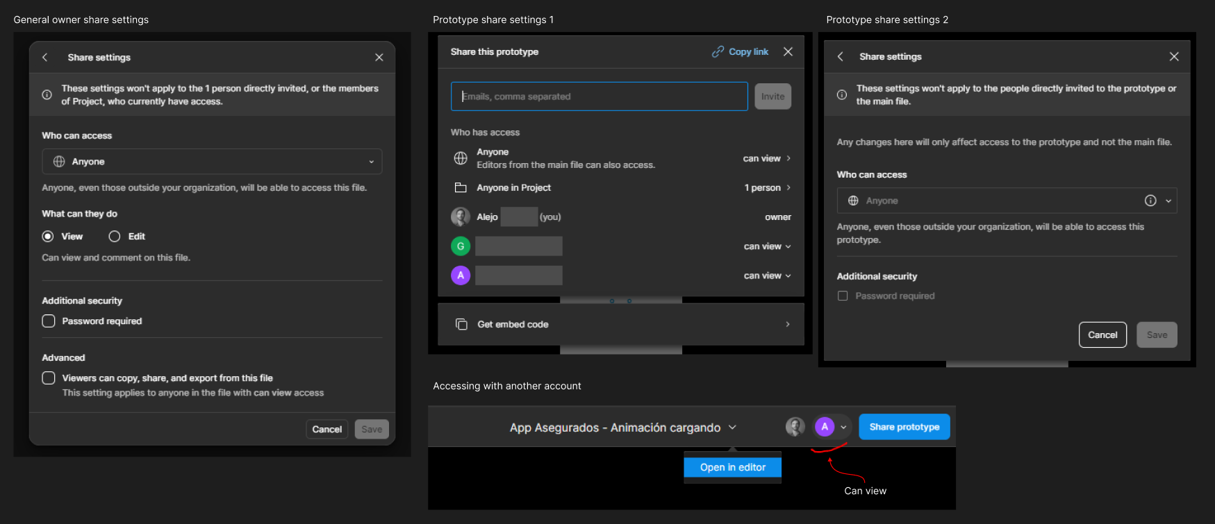

Hello dear Community,
As we’re continuously working with clients, our team was really fond of the setting “can view prototypes only”: sometimes we would invite specific people to view a prototype, other times we would allow anyone with the link and password to view the prototypes. This allowed us to be sure not to share the actual design file with the client (sometimes because they wouldn’t need it, or because we would prepare a specific file for the client).
Here is a screenshot I found online for reference:
We recently figured out that Figma updated the Share modal:
So, the text in the bubble seemed clear, but then the settings texts just got me a bit confused, I guess it’s because they use similar wording which might seem contradicting at a first glance (keep in mind my team and I are not native English speakers):
Screenshot 2024-05-23 at 16.23.47
Furthermore, we got quite overwhelmed as we’re working with files which are 2+ years old and those are shared with clients, therefore we wanted to check if any settings changed. Some files have this message over the share settings:
Screenshot 2024-05-29 at 10.49.57
Do you have any recommendations to follow? Am I the only one who got disoriented from this update? I also looked up on the Figma help platform, the forums and anywhere on the Internet but haven’t found anything specific.
PS: I really hope Figma will create a Best Practice guide page which could be really helpful and inspiring on this matter!

Hey All, sorry for the continues trouble and confusion!
We did recently change the entry point for sharing prototypes with prototype only viewing access.
To share prototypes only, you will need to share from the “Share prototype” button while in the prototype viewer and not the Share button in the Editor view.
The steps to do this are:
  1. Open the file in Presentation Mode by pressing the Present button in the toolbar
  2. Click the blue “Share prototype” button at the top right
  3. Select Only those invited.
  4. Select Anyone and then save. This means anyone with the URL to the prototype will be able to see just the prototype.
After saving, copy and send the link to those that should have access to view.
For more information on the sharing options, you can also see: Share files and prototypes

Hey! I just tested this and followed your steps above. The only issue is allowing (approving) an invited user to view your prototype also allows them access to your design pages. There is no option to grant them access to one or the other, they are both combined now, regardless of if you click the link while in presentation mode.
After I was granted access to one of my personal projects with a fake Figma account, I could see the prototype and the design pages. The only way for me to see both of them is through a direct link. But there is no restriction stopping me from seeing the design pages.
It would be helpful if on the “Share this file” page you had a dropdown that says “can view only prototype”, and when someone used the direct link to go to the design pages they are blocked. Where as right now you are not blocked.
